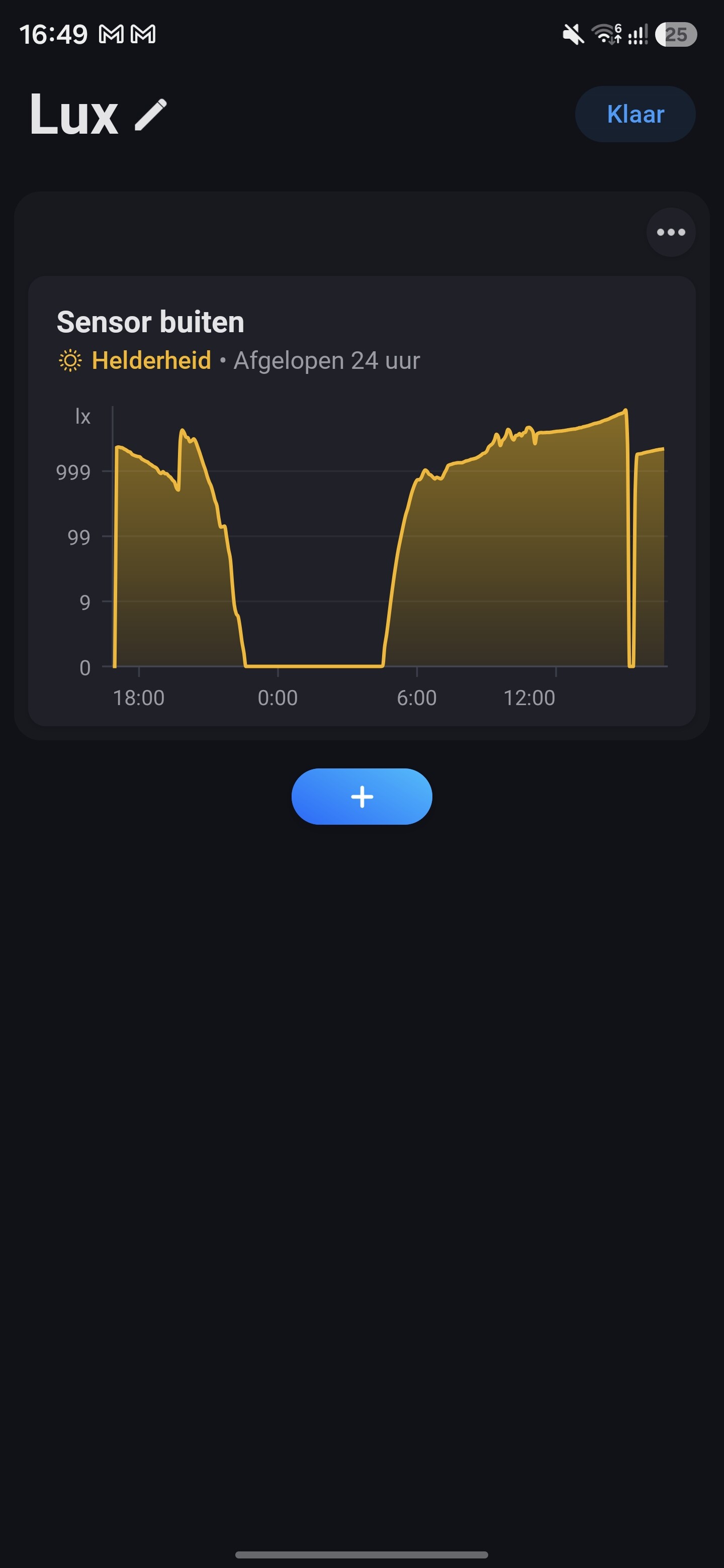

If you check your insights for the lux, does it show the 0 also for a moment?

But does it show the lux going to 0 in the insights?

Insights show the exact gap to 0, and me starting manually.
