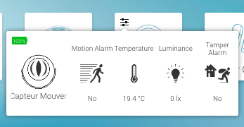

When I say “It works great” I mean the motion detection works:
23

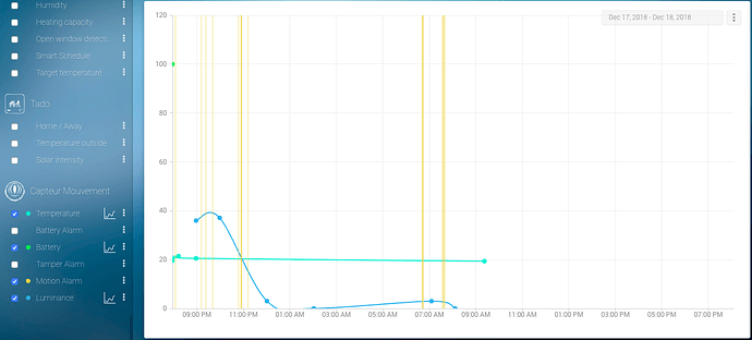

BUT
Temperature, Luminance and battery reports are sh*t ! Here are reporting since yesterday 8pm (when I installed the FGMS).It looks like the report delay is completely random ! (I’m not at home since this morning that’s why there is no Motion Alarm)
I hope one day I’ll be able to use and trust temperature reports to control my radiator valves but as you see now, I can’t get useful information…
