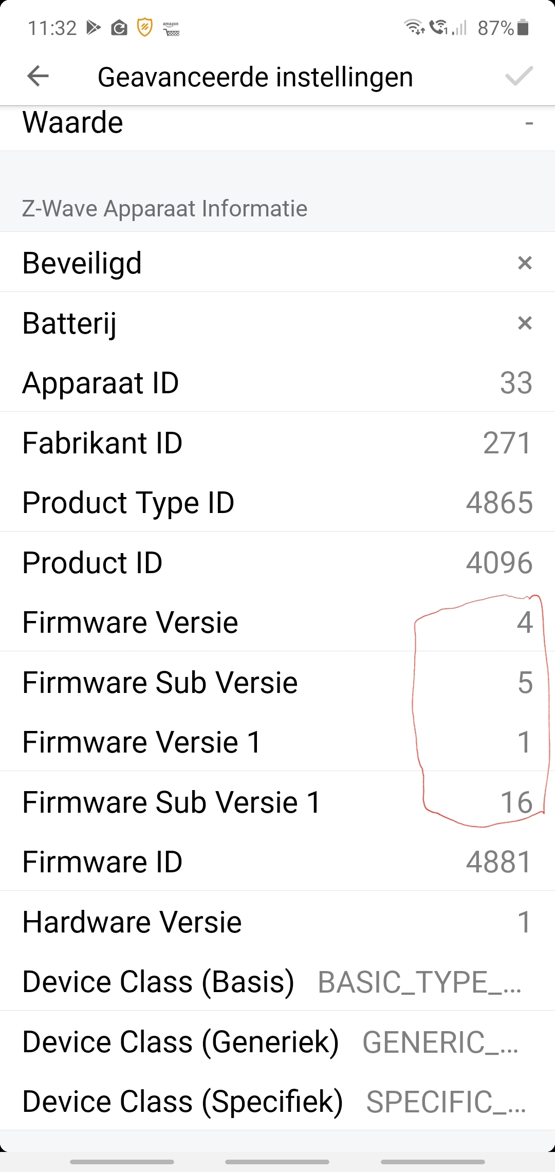

What’s the firmware version of the heatcontroller?
Good question. Can I check that somewhere?
Is it possible to update the firmware through Homey? I have the same issue with other third party devices (Philips Hue for example).
Advanced settings in homey itself,
And updating is not possible due to protection from the manufacterers, I bought a second hand fibaro lite and updated the heat controllers now everything working fine

under 4.5 firmware the heat controllers react instantly
Under fibaro firmware 4.5 for the heat controllers everything fixed and working however battery life decreased to about 2/3 months iso 6. But I dont care now very nice fast control
