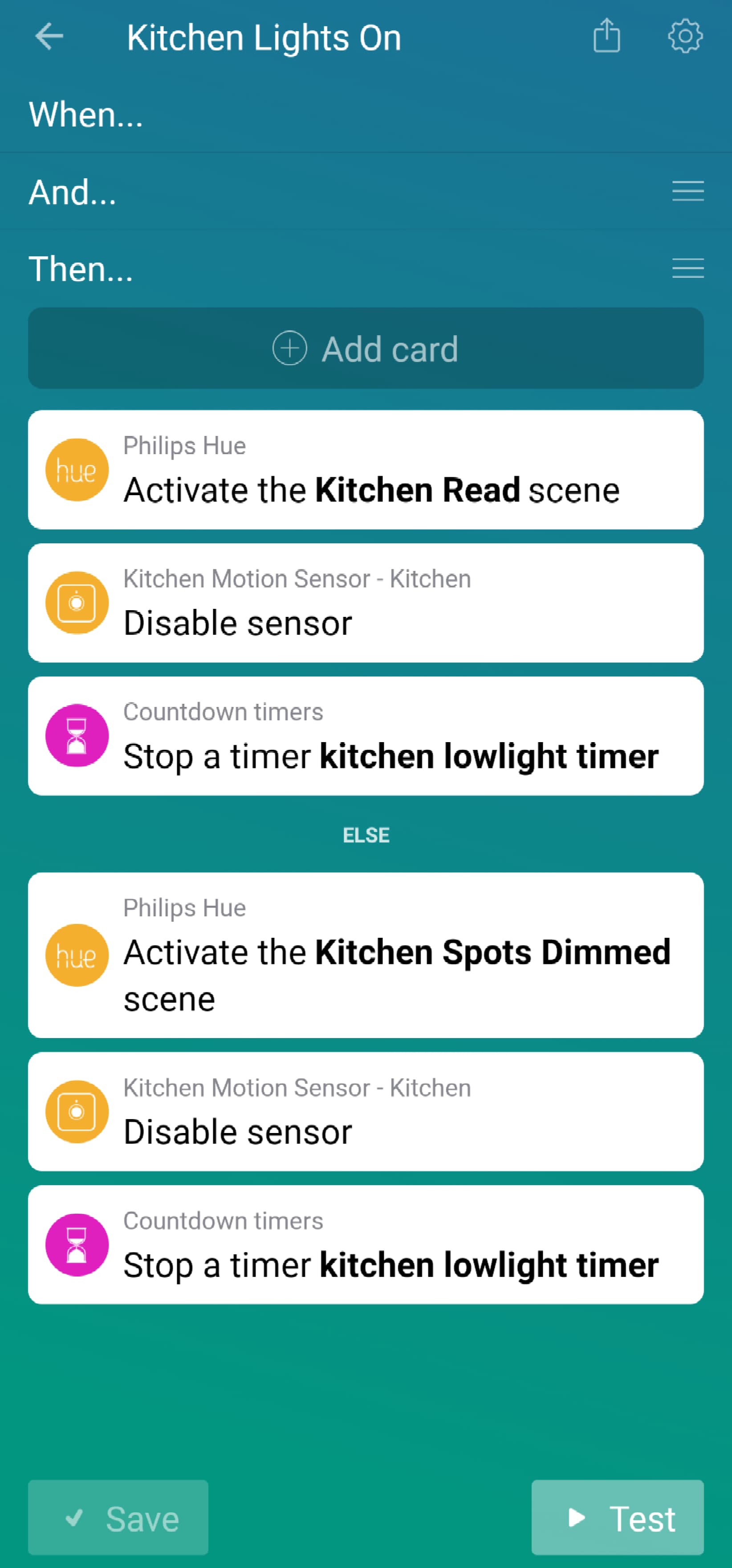

What I did in previous flows was if I wanted lights to be on and not be affected by the lux sensor was, when I push button to switch on the light scene I wanted that flow had a card to disable the sensor. The when I manually turned off the lights that flow had a card to reenable the sensor
Interesting. How do you unable a sensor?
Before with standard flows we also didn’t have a ability to disable devices. If you disabled flows that is still possible, nothing changed in that for AF.
Philips Hue sensors can be disabled in flow, there’s a card for that. And can be re-enabled in a second flow
Make a flow for the lux-sensor that before changing the light (on/off) checks whether the manual switch is on or off. If on then do nothing.
A much easier way to solve this, no need for disabling.
Ah, i didn’t know that specific device capability. But that should also work in a AF.
