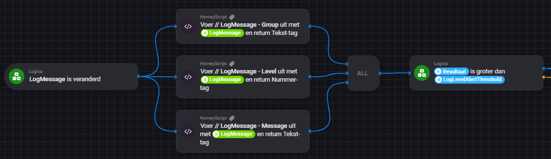

I like the JSON while it is very readable, but also error prone in writing it.
My solution is a bit different, but kinda similar although the parsing is a bit more work maybe…
I set a Text Logic card to the following:
<group/type>;<priority>;<message> and then I parse it like this:
text values I retrieve with the following HomeyScript code:
// LogMessage - Group
const msg = args[0];
let elm = msg.split(';')
return elm[0].trim()
2nd field, which is an integer:
// LogMessage - Level
return parseInt(elm[1].trim())
You can create your own alternate solution like so and adjust the HomeyScript accordingly
type=<myvalue> prio=<50/high> msg=<hello there> (instead of spaces you might want to use something like a colon or semicolon to split the values)
Might be simpler than JSON in the end…
