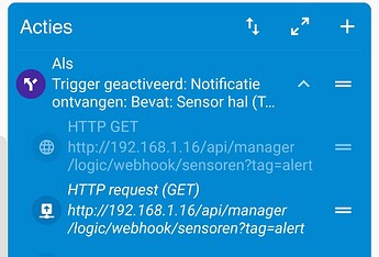

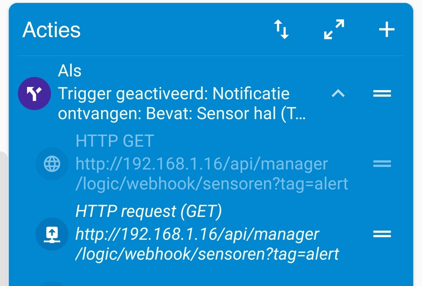

I took a look, they changed ‘HTTP GET’ to ‘HTTP request’, where you can select the GET method.
So that means you have to edit your macros…
Go to ‘Applications’ and pick ‘HTTP request’
Enter the url of your webhook, save it, et voilá.
But thanks for the alert, I didn’t know what was going on yet and now I know :upside_down_face:

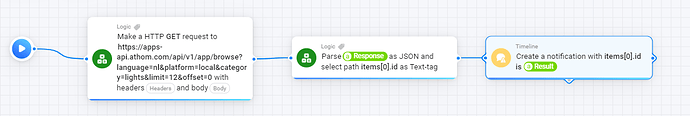

Anyone having an idea how to create indexed variables not using Homeyscript? I am using JSON in a text variable currently.
Logic cards ca do a lot nowadays,

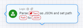

Above works, and the reverse of the card is I think:
This is more or less how I do it currently.
But I didn’t know you could index it like “item[0].Id”. Is “Items” a return variable from the HTTP card?
I do it like this:
StateVariable = {“Sensor”:“House”,“State”:“Normal”,“Temperature”:“20”}
And then I parse is as JSON and uses paths like “Sensor”, “State”, and so on.
