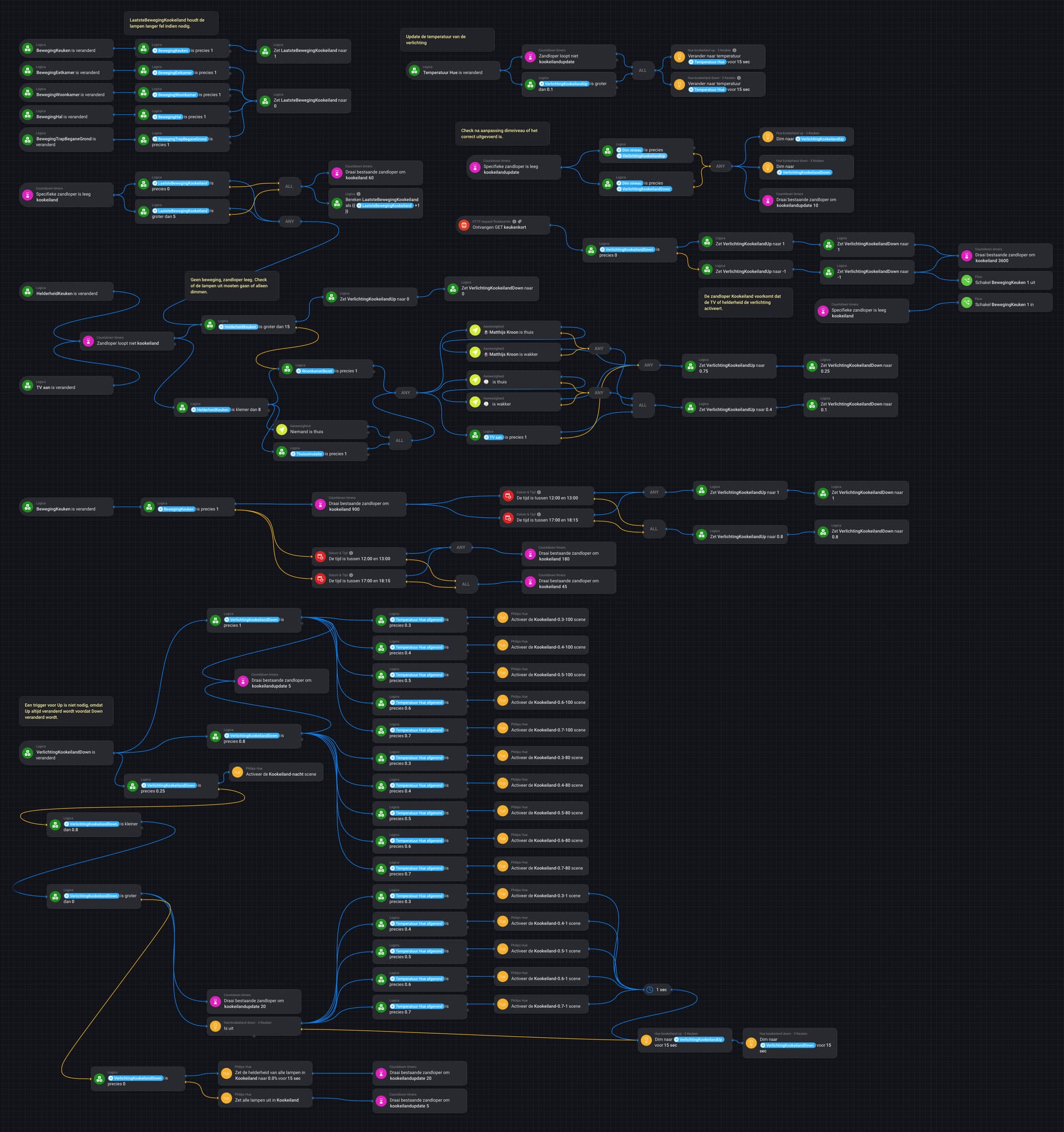

I created the following (advanced) flow:
This flow works fine, but when i remove the logica flow card ‘Airco_boven bevat Off’ then something weird is starting to happen.
I turn ON the airco (using the device on/of button) then you hear the sensibo device peeping for minutes, every ‘beep’ is 1 command given. I added a log to the flow and indeed the flow seems to be looping, it keeps (re)starting itself, the log is constant filled with the same data. There is no error.
The strange thing is that the device is turned on only once and then the flow just keeps repeating itself until i disable the flow or switch the airco off again.
When i use the test from here option all works fine, the runs once and stops.
So no idea why the flow keeps (re)starting itself…
I added a logica flow card to check the state of the device and now the loop is gone, but that card should not even be needed, the flow should only run once when the device is turned ON, not constantly.
Maybe but is it related to Advanced Flows?
Pls create a Simple Flow with the Trigger in the Left Top corner to Log a Notification
Delete or Disconnect That trigger here. and Test from fe the 1sec Delay if the Notification appears?
Looks to me an issue in the “Arco” (sensibo ? ) App and not related to an Advanced Flow that even is it is already on Triggers again on one of the Action cards you use.
i did, a simple flow with the same starting flow card is only executed once
The advanced flow is executed constantly…
