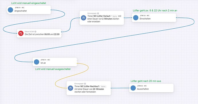

Would the flow work like this? Or would you rather create a flow for on and off?
Did you test the flow?
No, this flow doesn’t work. The problem is, that the timer cards of the chronograph app doesn’t work like this.
This is also wrong:
This flow card Ist an is a condition card (And…). This card checks if the light is on or off, no more, no less.
It doesn’t trigger like you write “Licht wird manuell ausgeschaltet / Light is switched off manually”.
