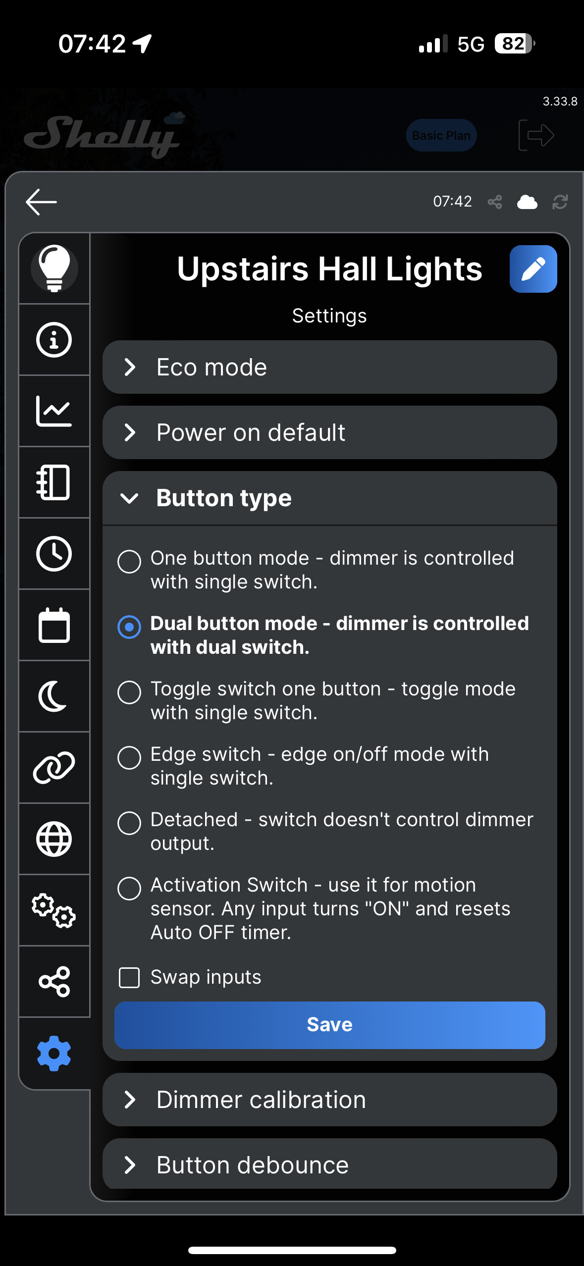

As far as I know there are a couple off settings what kind of switch you are using.
Maybe you can make a screenshot off that settings and place it here.
And what happens when u use the Edge switch? With that setting the light will change every time when you press the button.
So when light is on it turns off, when light is of it should go to 100% like the flow says.
