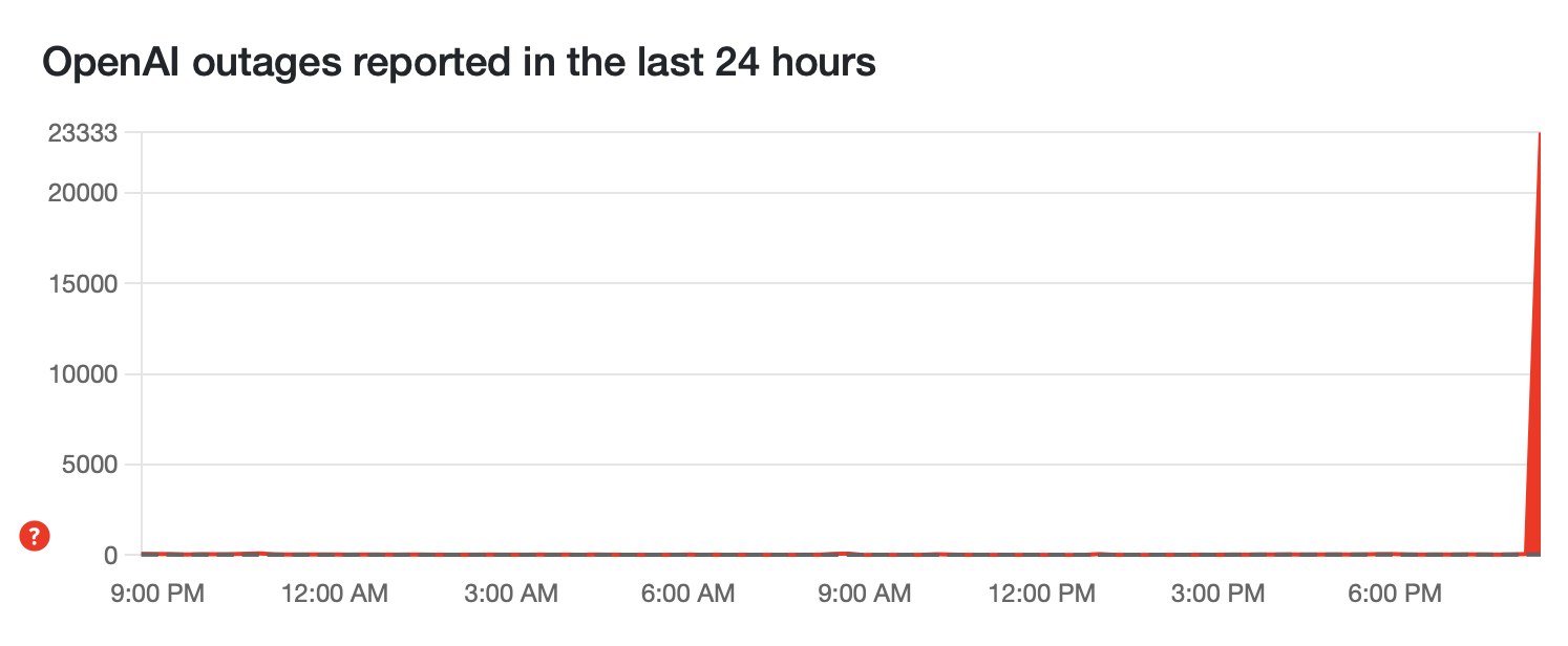

Well, to be honest, I just asked ChatGPT (which incidentally is down now :thinking::joy:) and that’s where the answer comes from.
