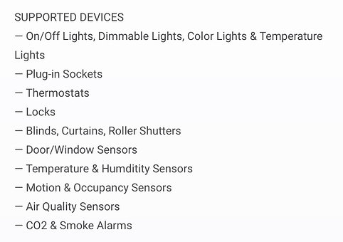

Acc. to the info in the App Store, these following devices are currently supported:
(Source)
I don’t see a leak sensor in the list… :man_shrugging:

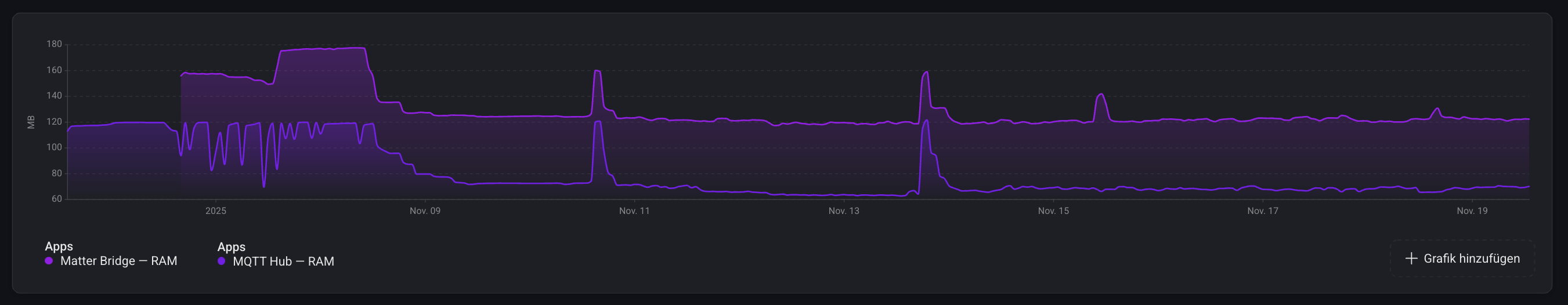

The only thing that bothers me so far is the enormous memory usage of approx. 120–130 MB RAM on average.
The app with the second-highest memory requirements uses “only” approx. 80 MB RAM.

There is absolutely nothing wrong with the statement itself. It’s definitely possible to make 433 MHz and Z-Wave devices available in Apple Home.
The Homey App Store provides information about which devices are currently supported:
(Source)
But no screens, speakers or garage door openers are mentioned… :man_shrugging:
