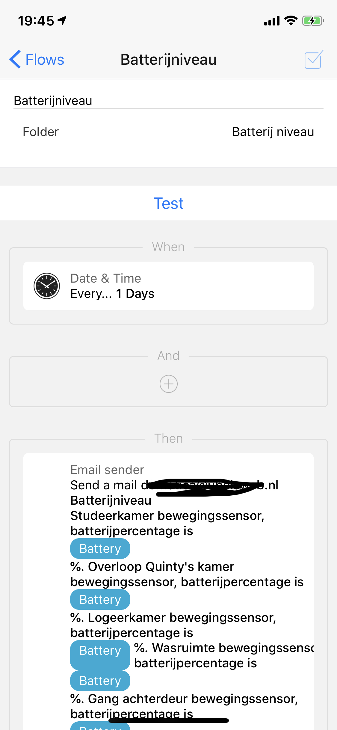

My problem is simple. The flow i use does not work. Why? What I want is to get every day an email. But after two times getting that email it stopped sending these emails. Also I want to create another flow that I get every 35 days on a thursday an email. How can I do this?
It appears very simple, probably I am overlooking something here. Espescially the 35 days flow is tricky. How does homey know when to start that flow every 35 days.
I posted a new picture so you can see it. Strange thing is that it indeed does not work. After two days it stopped working. When for example i try the same flow with 35 days, 35 days from what? From now, from tomorrow, from the day i made the flow, from the moment the flow runs the first time?

But looking at your flow it looks like you are monitoring battery levels.
Is that your goal? Monitoring how fast your battery’s drain?
If it is not you might take another turn with your flows and see if that work better:
Use the battery level in the when and teigger when its low.
This way you only get an email when your batterys go below a certain level.
Less spam to your and no issue figuring out how to sent mails every 35 days :wink:
Right that indeed was what i am trying to do. I have multiple emailaccounts so that will solve the problem of the amount of emails. Also i try to ubderstand how this trigger works. I can not figure out why every 1 days or every 7 days does not work properly. With the 35 days i try to get a email that the paperbasket will get emptied. The trashcan reminder app does not work for me.
Make a number variable with the better logic app.
Trigger at 0900 AND BL variable is NOT 5 AND it’s a thursday THEN increment the number variable with 1.
Trigger at 0900 AND BL variable is 5 AND it’s a thursday THEN send email AND set numbervariable to 0.
