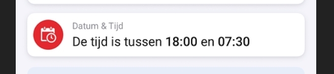

Hi, I’m quite new to homey and actually started to make the first flows. The most work. But I have one shown below that I do not get to run. I think it’s the first trigger that doesn’t kick off the flow, is the problem. But what do I miss?
If I start the flow manually, everything works as it supposed to work.

Try to remove the 1st chekc in the ANDsection (eufy is on)
Dont have an eufy so not sure how it behaves, but if it is just triggered there should be no need to check if it is on i guess…

A note about the use of this card:
Homey isn’t very good in processing conditions covering two days.
To workaround that, it’s best to invert that card twice:
This has exactly the same result.

Based on your screenshot, I’m assuming that you want your garden light to go on when motion is detected at night. Rather that checking on time, you might want to consider using a card checking whether it’s night. That way, your flow will adapt itself to changing daytime light conditions in summer and winter.
PS: You will not immediately see the card “Het is ‘s nachts”. Instead choose “Het is overdag” and use the invert (omkeren).
