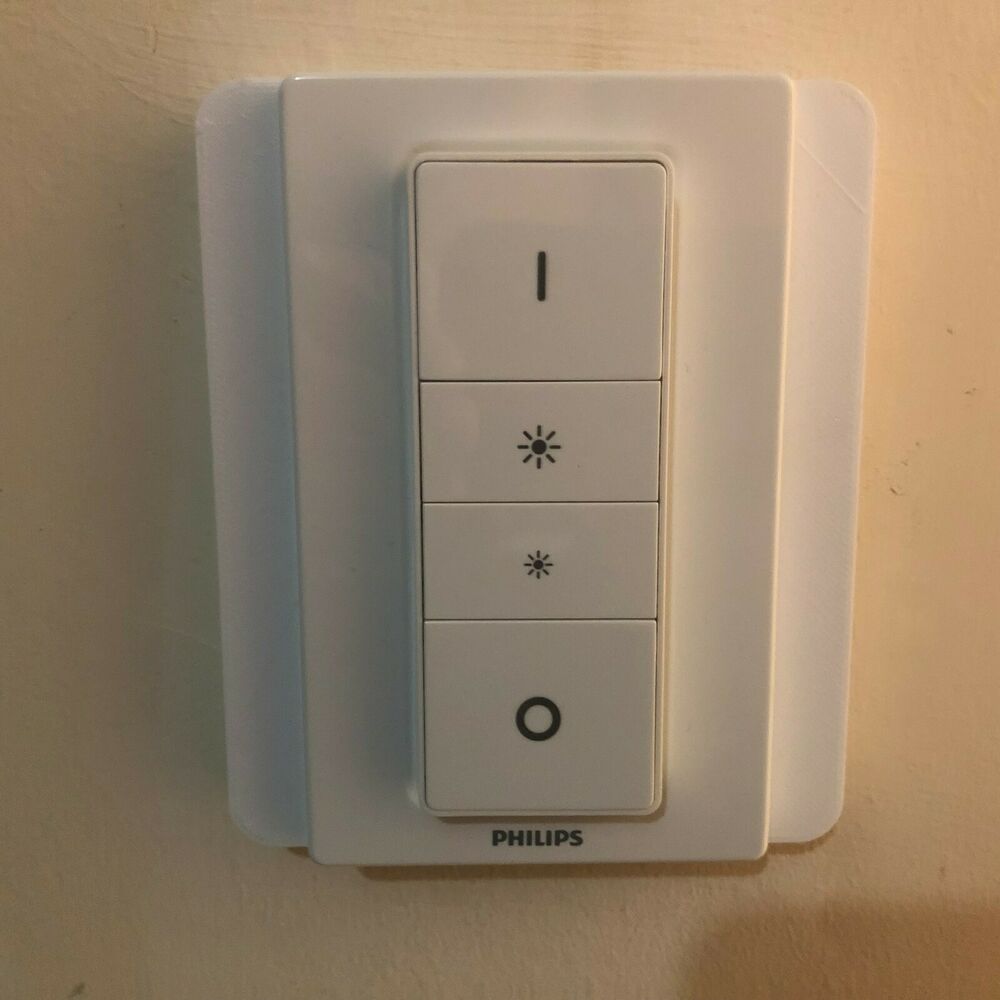

In the UK we have some faceplates available that affix over the existing switch plate stopping the existing switches being easily accessible. Then they allow mounting of the Hue dimmer switches on the front that are magnetically held. Two or One Hue dimmer is supported. Would those suit and are they available for Nordic switches?
Heres a link to such UK version on Amazon/eBay but yours will be different.
I have done the same as @xAPPO but then in the netherlands which are a bit different, dm me if you want me to explain in dutch because thats not alloud here
