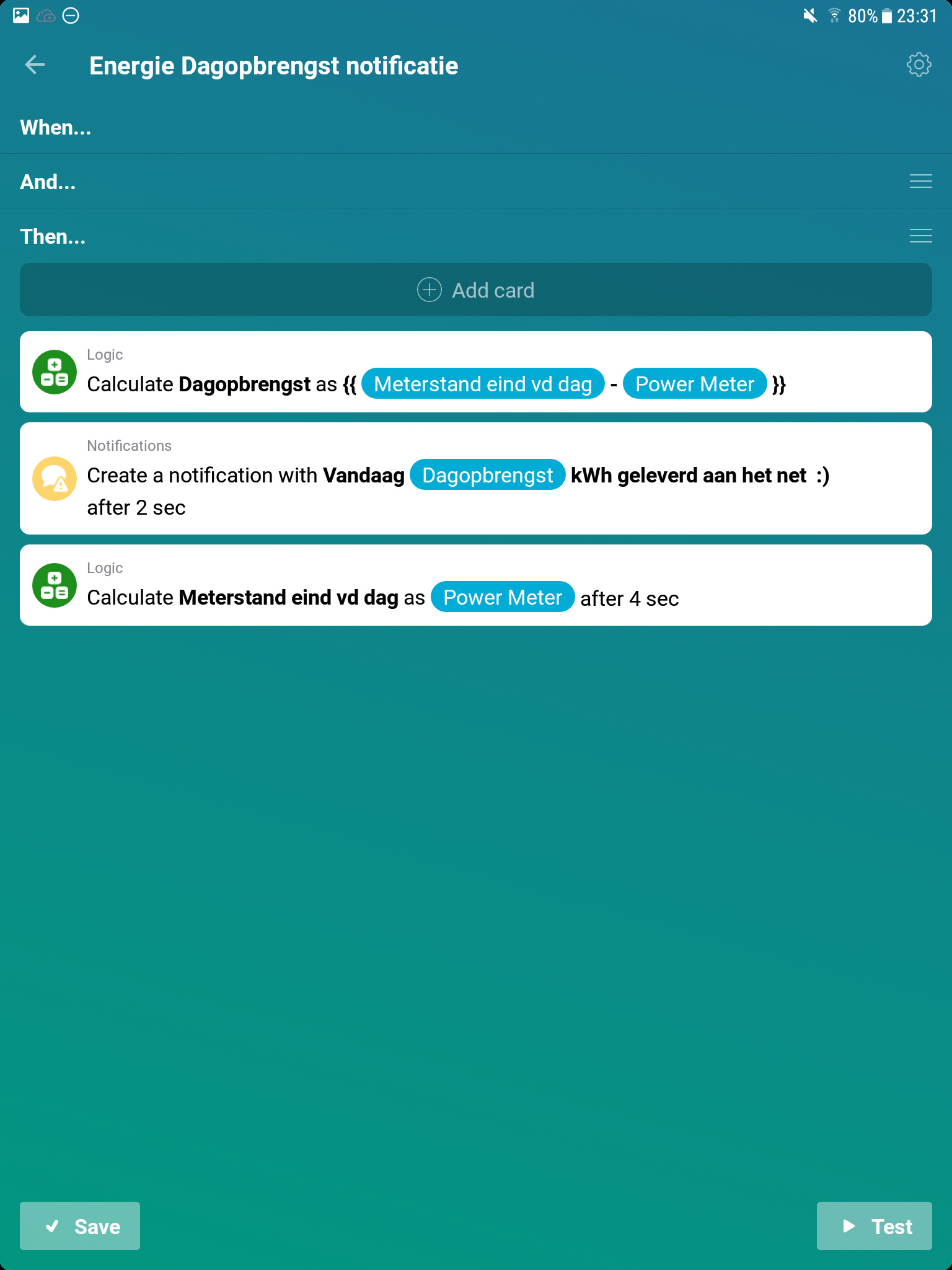

In the meantime you can use varaible and better logic.
