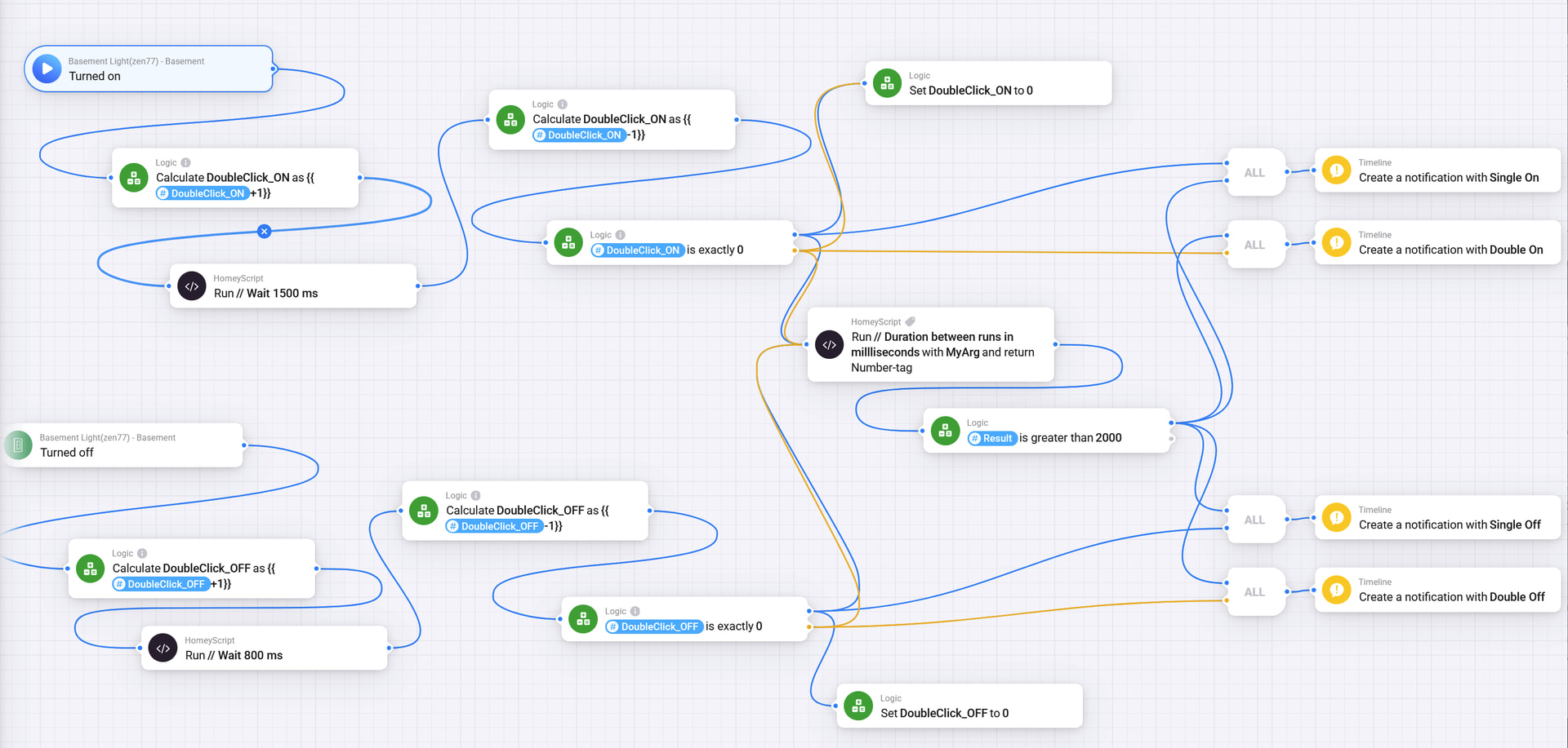

I’ve been trying to add double tap functionality to a light switch with no success. I found a good tutorial that I can get to run without errors however, it always executes a single tap no matter what i do. In the tutorial he is using a remote switch and my switch is hard wired. Could this be issue?
I was able to recreate the flow (I think) but it’s in Swedish so I probably missed some things.
Bellow is the flow I made.
and this is the script which I got from the video”

any help would be greatly appreciated!
I have an update:
The reason the double tap flow wasn’t working is because most of the Zooz switches do not send additional ON taps after the switch is On or OFF taps after it’s switched OFF. Zooz support has told me this will be fixed in the next app update. the current version is 1.0.27
