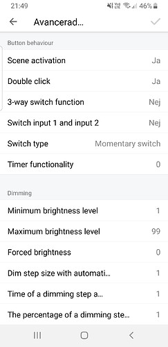

The scene activation functionality (SAF) can be activated in the advanced settings of the Dimmer 2: Long tap on the device tile → :gear:-> Advanced Settings
Because I don’t use a Dimmer 2, just Walli Dimmer instead, I don’t know if there is a parameter for SAF or if you have to do the settings with raw configuration.
If the setting has to be done via raw configuration, then you have to use these code.
For S1: ID*,1,14
For S2 it depends on which switch is used an which SAF you want. Because with the S2 it’s only possible to use 1 kind of SAF, 2 klicks or 3 klicks.
*ID means the Node ID of the device. You can find the Node ID also in the advanced settings of the Dimmer 2.
Maybe you post screenshots from the advanced settings?!
Next time please post the screenshot before I’m start writing a little manuell… :stuck_out_tongue_winking_eye:
Thanks! Managed to enable double click but haven’t figured out the whole setup yet (junior requiring attention…).
Plz keep in mind that the double click function is something totaly different then the scene activation.
