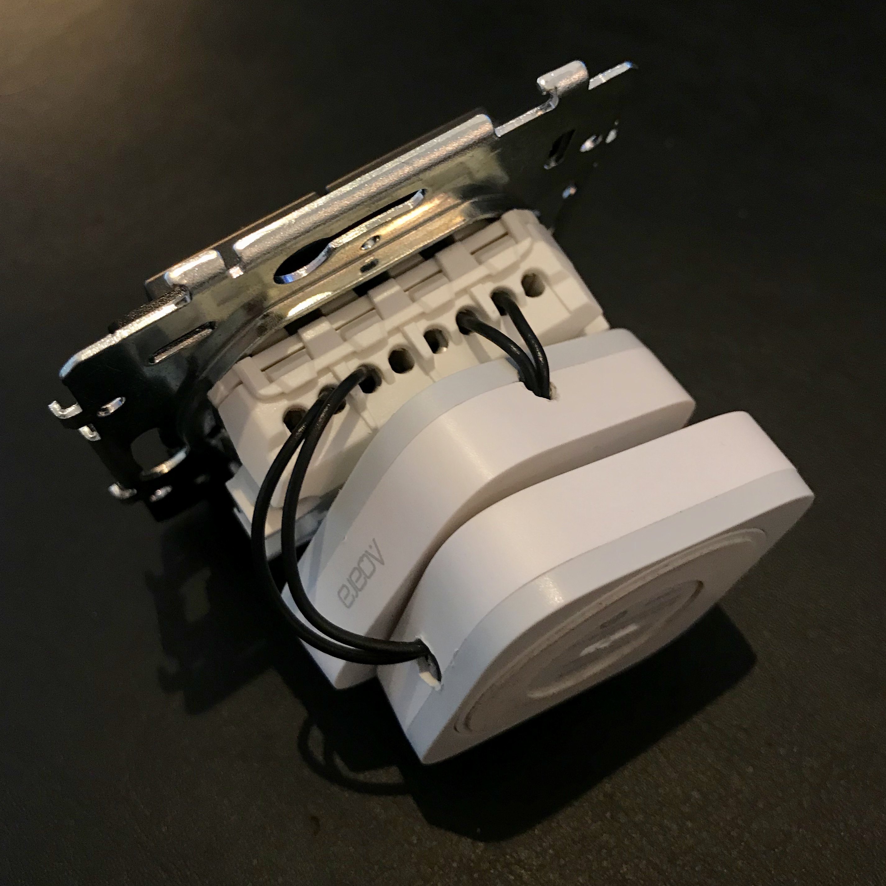

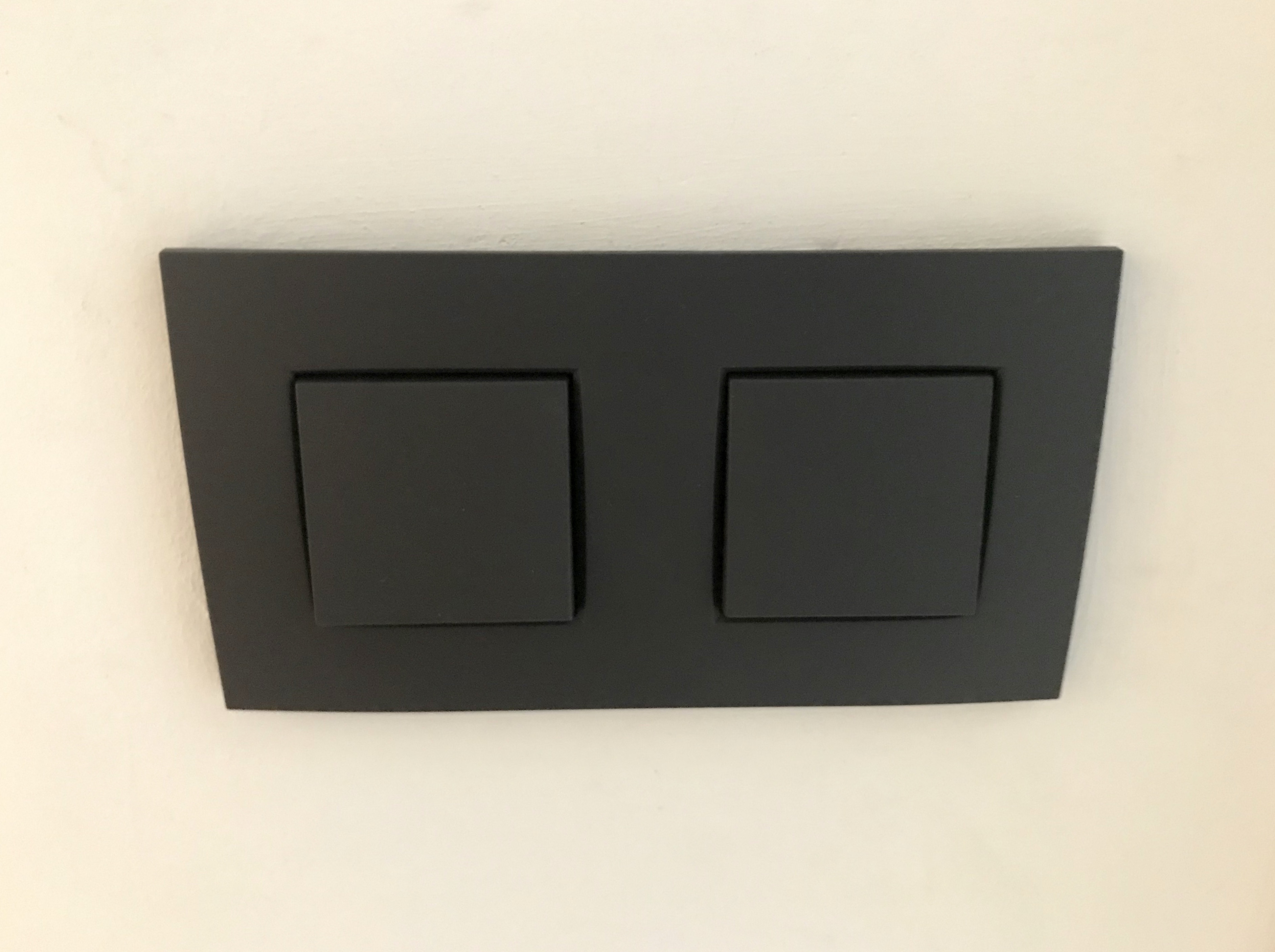

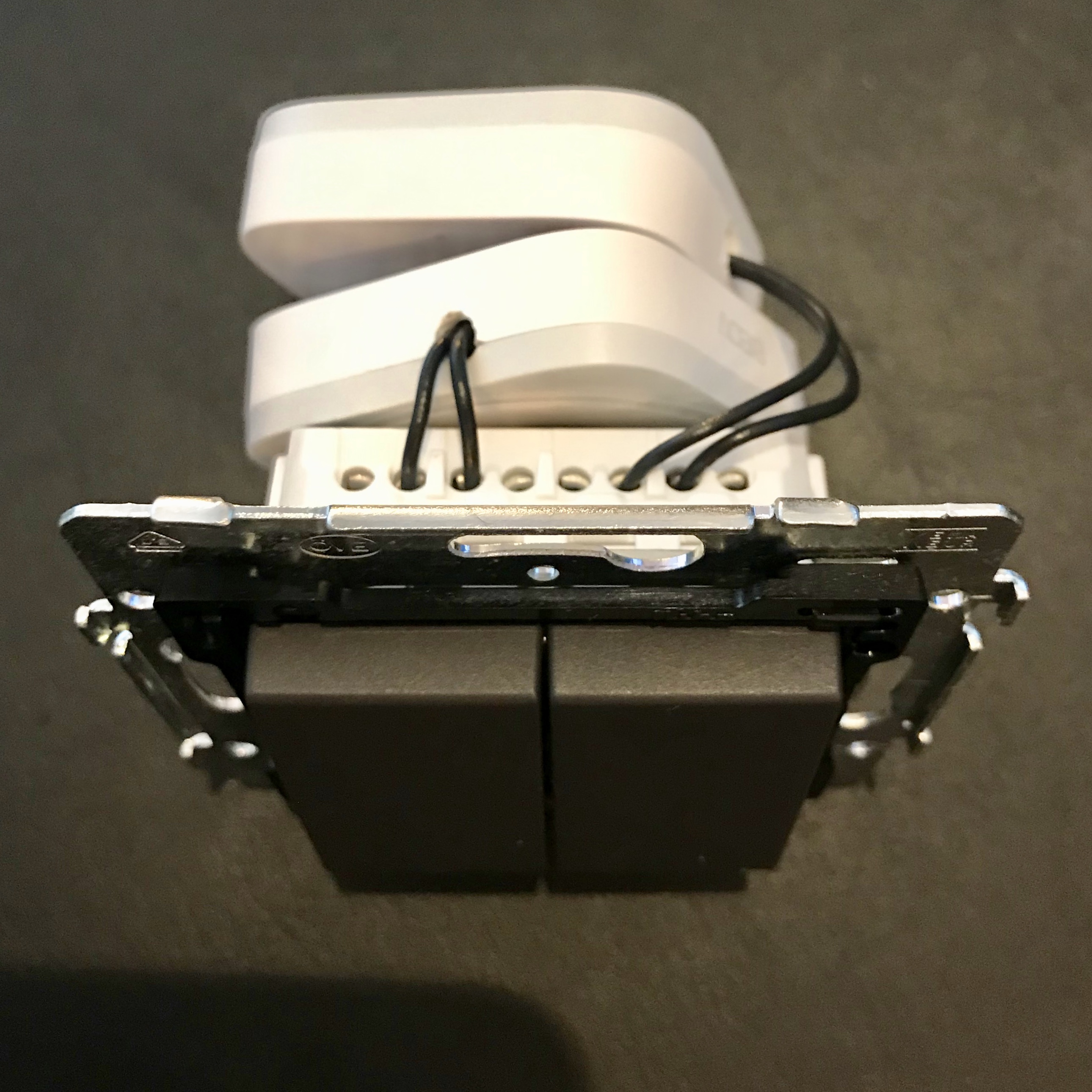

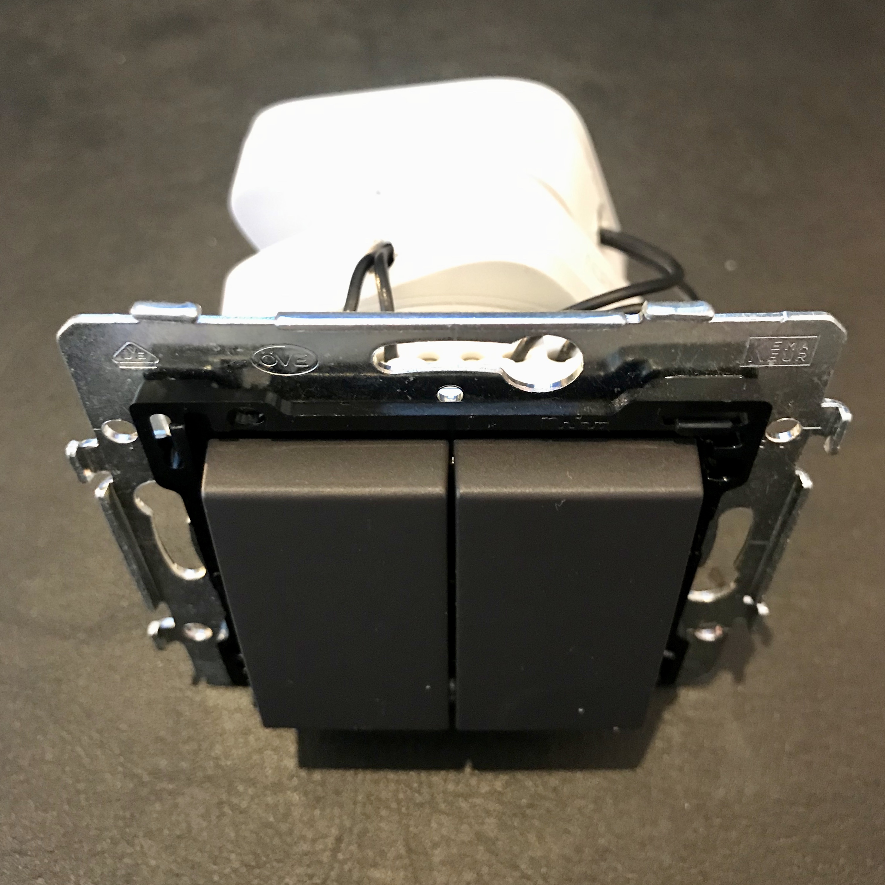

The solution is actual quite easy but gives an very nice looking result. I opened up an Aqara Smart Switch (7,5 euro’s on Aliexpress), found out witch pins are making contact when you push the button and connected wires to these pins. I bought some nice looking Niko push button, connected the wires and it works like a charm.

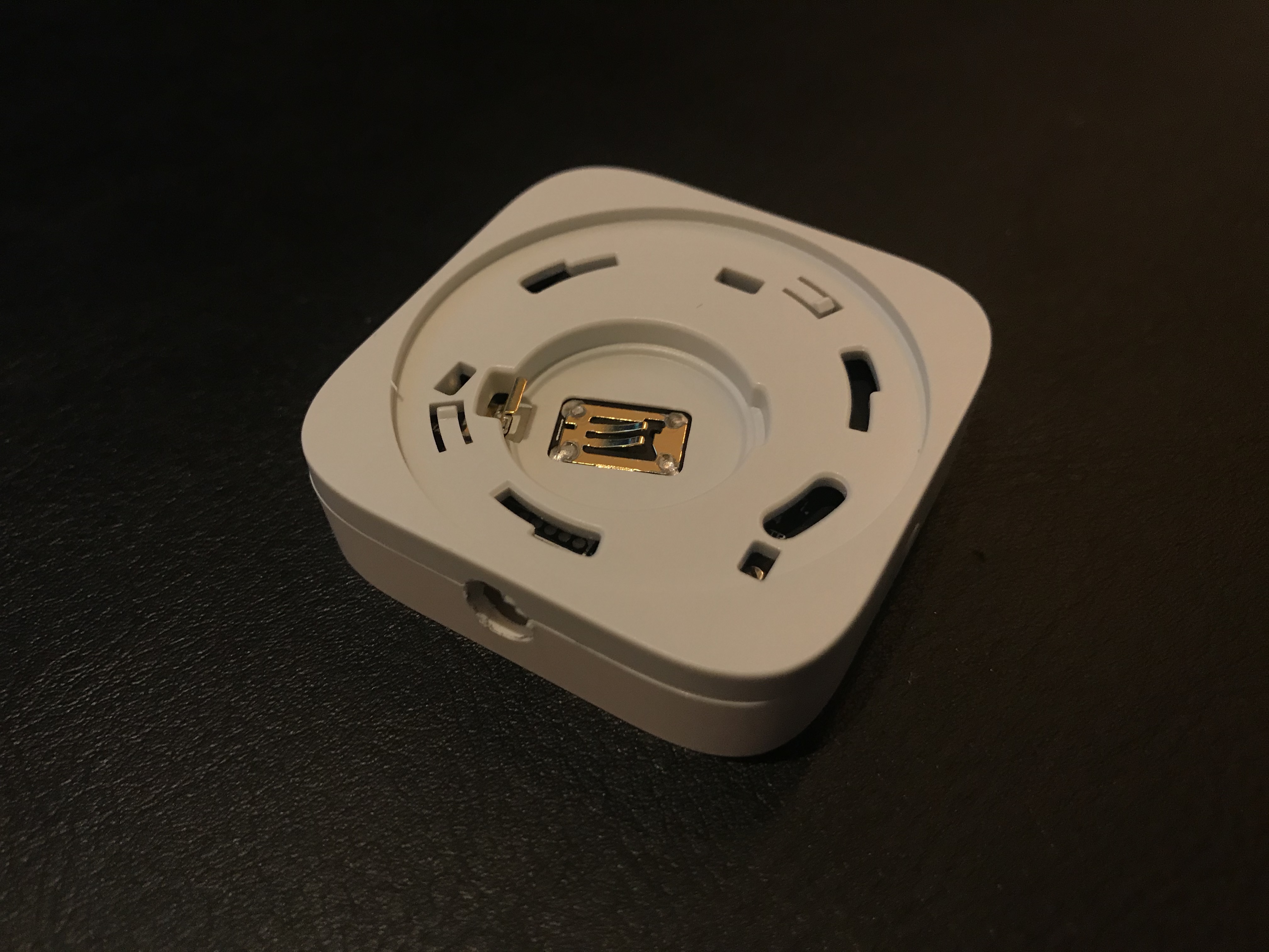

I carefully drilled a 5mm hole on the side where there is no logo, reset button or LED-light. I found out that’s the best side.
By removing the battery cap and the battery there some room to wiggle with a flat crew driver to open the case.

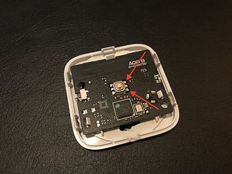

On the PCD you can either use the outer contacts on one side of the button to solder the wiring. It doesn’t matter which side.
After some trail and error i would advise to remove the plastic button from the case to prevent accidentally triggers by (other) wires in the electrical box. I also removed the small plastic reset button.
Don’t forget to link and test the button(s) before installing them in the wall :nerd_face:
