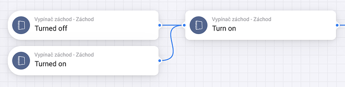

But i someone clicks on wallswitch it cuts power to light… So, I decided to send them back and get H1 with neutral and make the wiring litlle bit compliacated. But the only way I can make it to act as button is to make a flow which says - when its powered on or powered off, then turn it on and make…

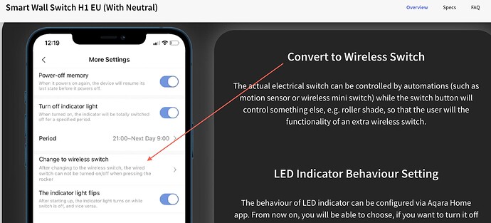

Thanks for answer :slight_smile: I will look for Shelly switches :). I was expecting this feature from this device as it is stated here - Smart Wall Switch H1 EU (With Neutral) - Aqara
I guess that the Homey app for that switch doesn’t support that.

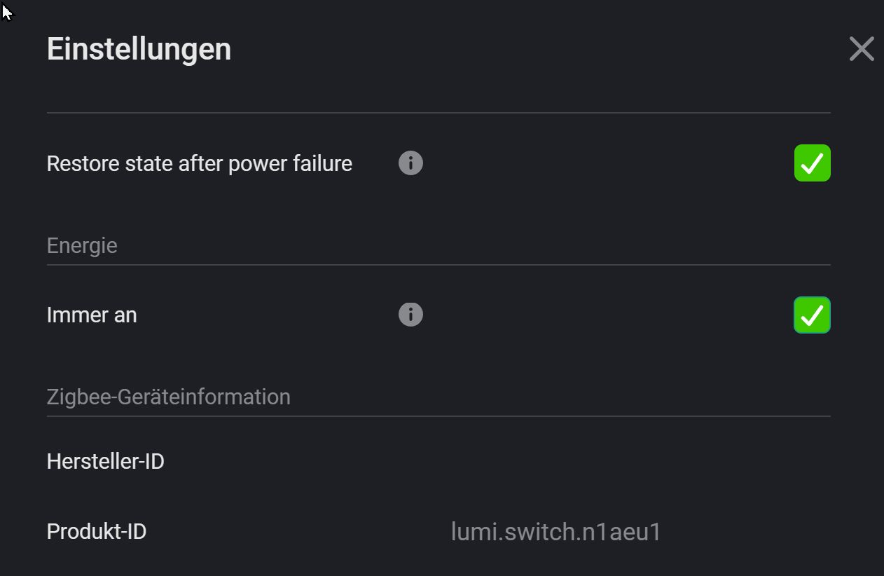

So isnt he “alway on” (German “immer an” setting in the Aqara app exactly enabling this "decouipled mode?
No, that’s just a software setting to prevent Homey from switching the device off (but it does nothing to prevent a switch action from turning it off).
