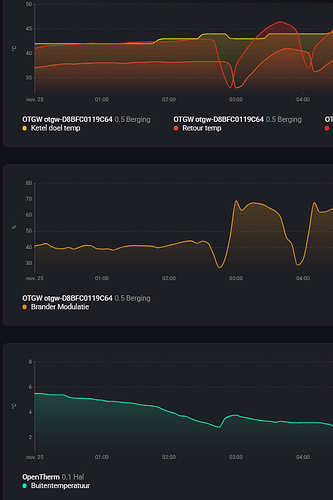

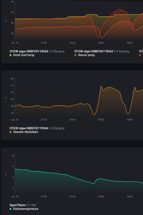

You can select the graphs you want (have you noticed you can drag a Tag from the left to an excisting graph on the right ? ) and let them overlap.
If you have selected all the graphs you want, copy the content of the adressbar and save it as a link or favorite.
if you open it, you’ll see all your graphs as previously selected..
