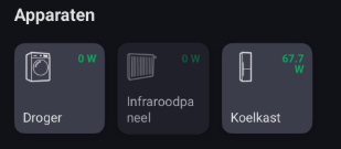

I’m walking into some minor troubles with the capability of my power plugs. For just 1 (infraroodpaneel) of my 3 powerplugs I’d like to use the on/off capability and for the other 2 I just not want to have that capability, but only the power measurement.
Like my fridge (koelkast) in my shelter; I’d only like to know how much power it consumes. By short pressing the tile the powerplug the fridge goes to an off status, by long pressing it goes to the details of it.
