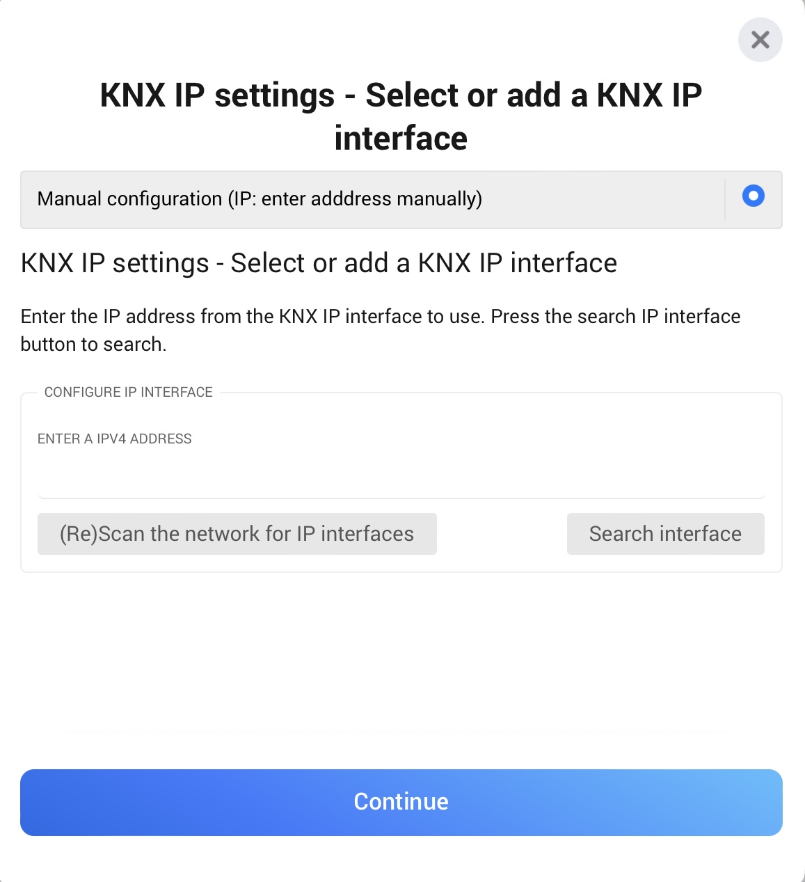

As you have to define the IP-address of ETS, it looks like the special dimmer card is doing the same as the general “listen to address” card.
Adding the dimmer to homey results in actually the same thing
When defining the KNX dimmer, you have to assign the group addresses (switch/status/dim) to the dimmer. The group address DTP is configured in KNX (so dimmer card as well as KNX trigger I use, are based on the same)
