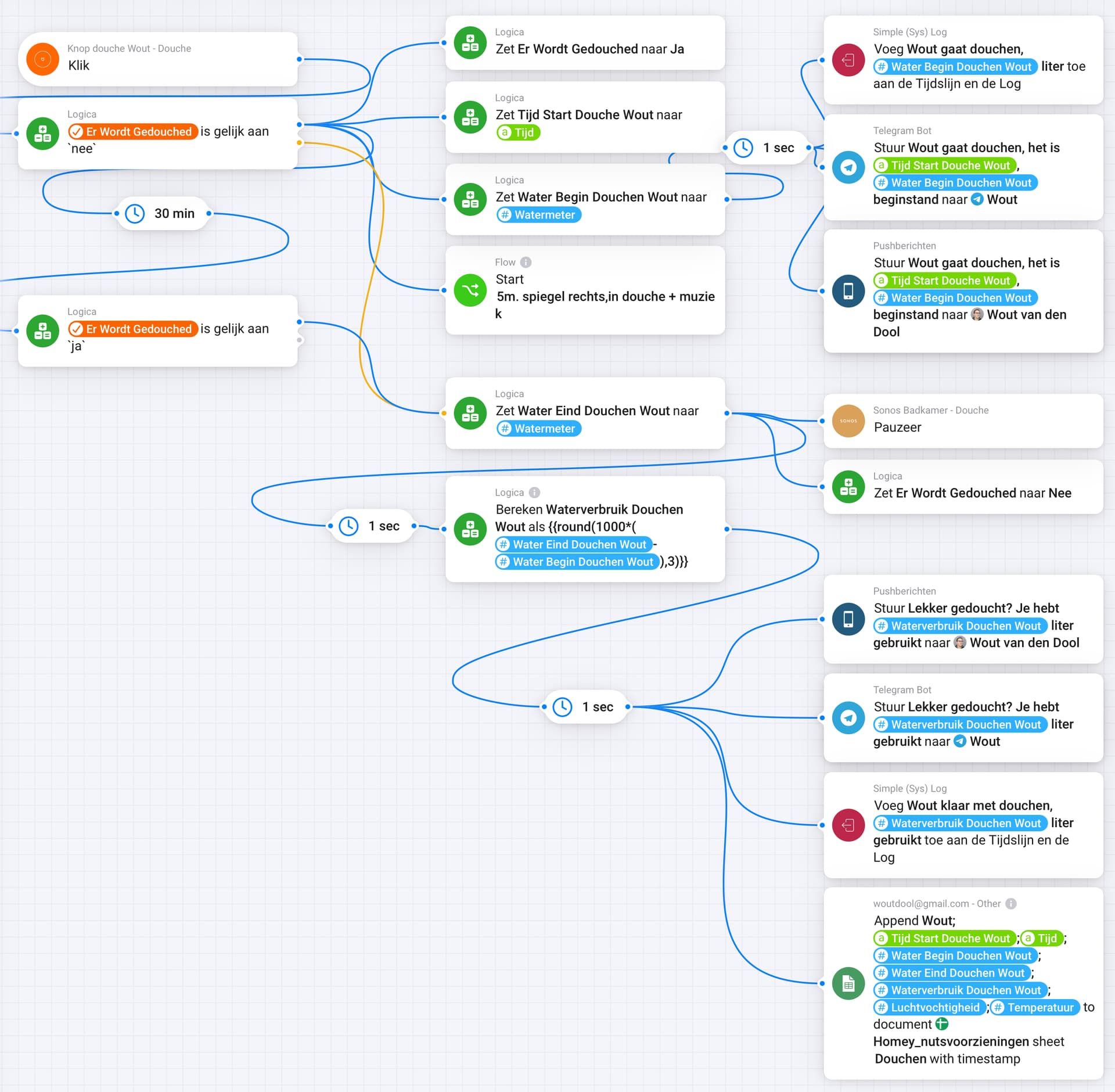

I build an advanced flow for my showering rituals. It has been working very well, upon till the moment I upgraded to HP23 and I had to rebuild my zigged network.

The strange thing is that in the Flow builder the flow runs as desired BUT in practice the flow runs different. A button press results in both situations are executed (start shower and stop shower).

Flow overview:
If I have understood the problem correctly, the shower starts and stops again immediately, right?
There seems to be a problem with the boolean variable Er Wordt Gedouched? So maybe the Yes and No output are triggered both in parallel?
Instead of all the other Flow Cards, add just 2 Timeline Notification Cards to the Yes and No output of the first Logica Flow Card and check it again.
