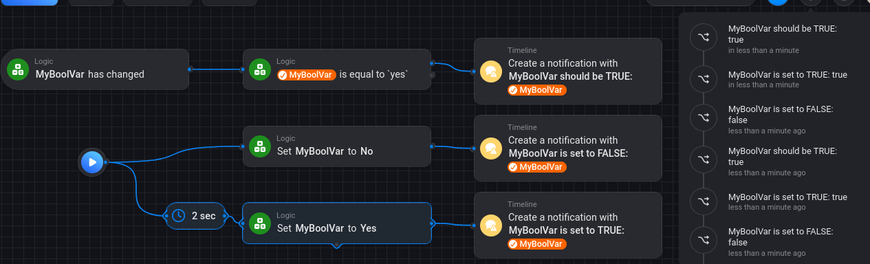

I have this flow where I set a variable, and to test it I’m doing something like “output current variable state, do actions, change variable, output state again”. The problem is that the first output gives the wrong value - which means the planned if test won’t work.
Anyone know if there’s something I should do to get the correct’s value?
In standard flows, delay the cards which should be fired after the ‘set variable’ actions. Action cards are not fired sequentially.
In Adv. flows, cards should fire the next card only when they’re finished, like one would expect. So here is no additional delay needed:

Don’t understand the problem. I build your flows on my own and it works as it should:
Or am I missing something? :thinking:
That’s really strange…Mine comes in as “yes”, I change it, when I write the variable again it’s still “yes”…Maybe I need to contact support, then? The whole behavior is contra to everything I know from development, and I just created this little snippet to test it out.
