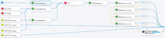

I’ve read your post several times, but I don’t get it. Can you add a flow screenshot maybe?
Sure! I just added a few of the triggers for this flow as an example. i have 7 “triggers” and 3 delay settings at the moment, but adding more later. If it was possible to use the number variable set in the logic at the start directly into the delay, it would be more efficient and easier then looping into every number to check if its the correct delay time and use one delay for each.
-Ståle
