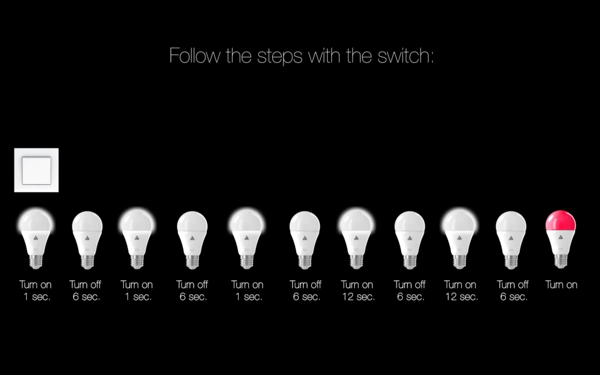

So then I needed to reset the bulbs to return them and the way to do that is frankly ridiculous. :joy: The bulbs are Eglo and here is a screenshot of a YouTube video of the sequence required:
I did not feel like doing this for seven bulbs manually, so I quickly created a flow to do it for me. After copying the different time stamps using delay I realised that 1 second delay gives about 3 seconds action in Homey. 6 second delay gives about 9 seconds and 12 seconds about 15.
So I had to do the 1 second periods without any delay, the 6 second with a 3 second delay and the 12 second 9 second delay. It should be stated that I used a 433 MHz plug for this and other types of plugs might be faster…but I could follow the progress in the flow and it was obvious that the strings between the cards (and the cards themself) add considerable time.

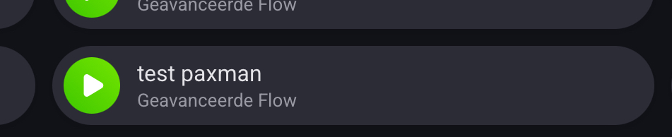

Also starting the Flow Execution in the left overview of Flows works as Execute and not a a Test like pressing the TEST button or Test From here on the canvas.

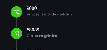

Using the test-button in edit-flow-screen the flow took 90001 milliseconds to complete.
Using the play-button in the flows-list the flow took 58089 milliseconds to complete.
All the delay-cards together is 58000 milliseconds.
So the test-animation takes 31912 milliseconds extra to complete.
