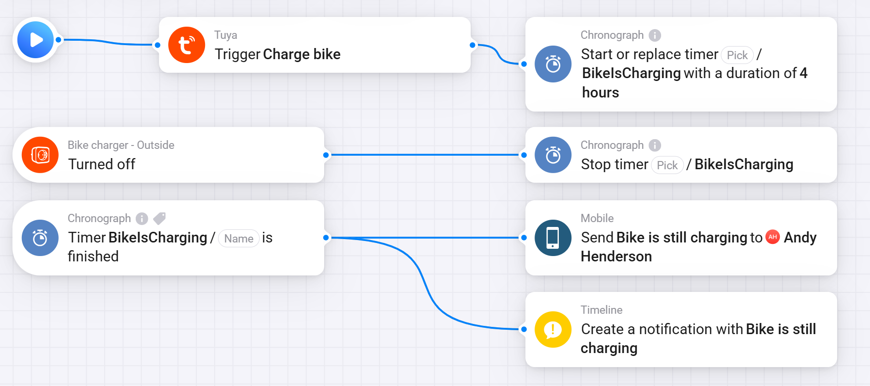

Here’s a simplified version of a flow I use to monitor charging of my eBike. When the flow starts it kicks off a Tuya automation that should start the bike’s charger and turn it off after 3.5 hours. It also starts a chronograph timer set to four hours.
When Homey detects the charge has turned off, it stops the timer.
If, however, the timer expires (after four hours) and Homey hasn’t seen the charger turn off (maybe there’s been a connection issue) it sends me an alert.
From memory, you have to create the timer (I call mine BikeIsCharging) in the Chronograph app before you can use it.
