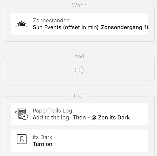

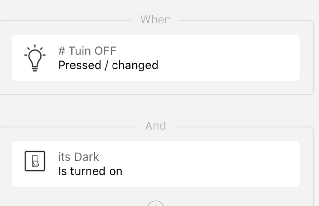

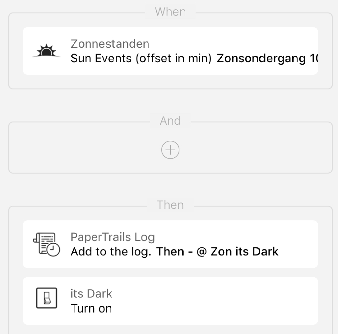

Create a flow that sets a day/ night status (for example with virtual devices)
You can use time, sun set, or lux input from a sensor as a trigger
Then use that virtual device in the “and” column to prevent the flow running during the day

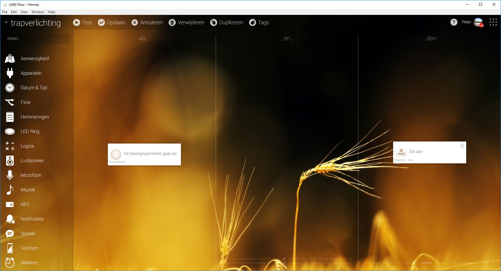

Here is my flow
Adding something like this?

Where did u input the 50 lux for the Coolcam?
With a simple logic card in the middle colom u can check for lux.
In the flow pages there is a Tag section on top of ur page. Click it and find ur Coolcam there.
There is a tag called “Helderheid”. Drag a logic card in the middle colom and select “is groter dan”. Then drag the tag into the card.
I did the input 50 in “lichtsterkte inschakelniveau” (third adjustment above associations)
My problem is already solved with “and…after sunset”.
Though your solution is also working and thought me about tags.
