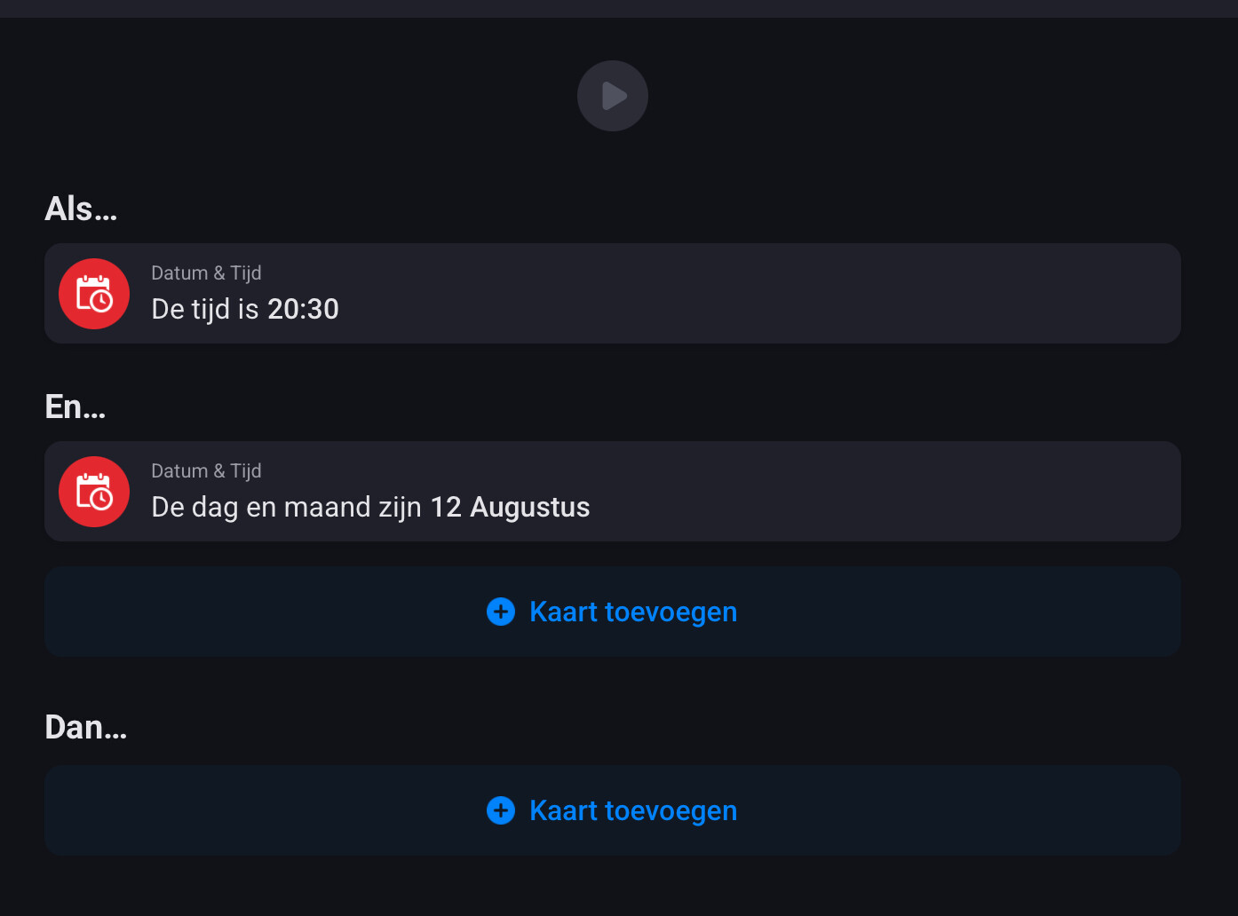

There is a Date & Time card “The Day and Month is (..) (..)
I used the month is card and the day number is between card with the All card or you could have the month card connect to the day card.
