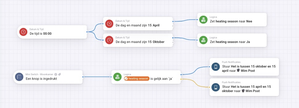

Work around:
Create a yes/no variable and change the value on a certain date.
Check the value when pressing the button:
Seems like a good idea, i would just have to create a variable for every different holiday on the year. I just figured there would be a way to ignore the year value in the card, nevertheless your suggestion does actually work, thanks!
