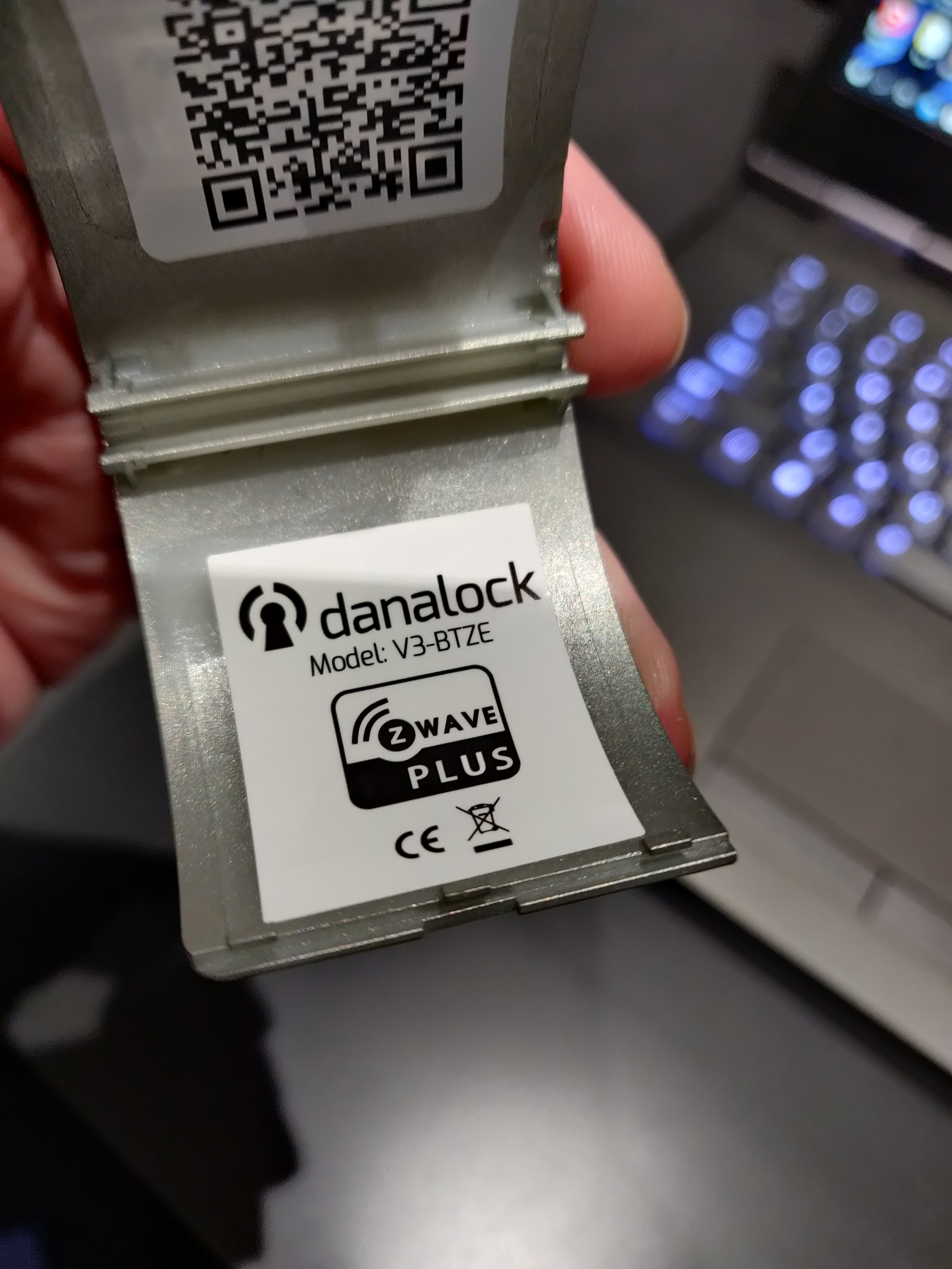

There is a serial number and QR code in the battery compartment, maybe that can be used to check somehow?

I was told by Athom support to message Danalock support to confirm zwave region. I’m pretty positive that it’s EU.
Danalock support requested pictures of my locks battery cover. I was also told on a different forum that I might have gotten a new version of danalock v3 with new s2 security protocol and Homeys Danalock plugin doesn’t work with it.
Can someone who managed to add their lock to Homey confirm that their locks battery cover looks like this?
