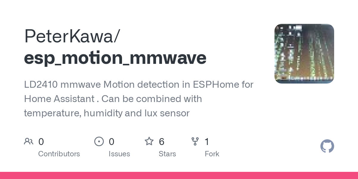

I’m new to ESPhome, not sure how to do it, does it need to get a device to setup HA so that ESPHome can be installed ? or Maybe D1 mini just flash with ESPhome firmware and just link up with Homey ESPHome application? Can you share how to do it ? :thinking:
I should’ve bought the Bluetooth enabled versions also. Going to order a few!
With an Aqara contact sensor it’s a bit more expensive, but then you’ll have a zigbee sensor instead of a wifi one. Just what one prefers.
The link was in my post with the linked post in it :crazy_face:
But here you go:
Feel free to ask away.
