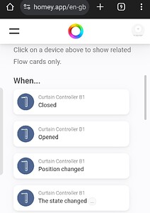

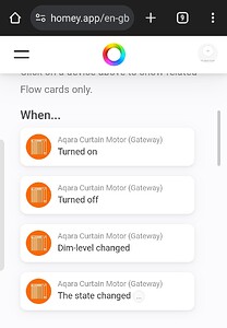

The Xiaomi app for the Aqara hub should have these usable trigger cards:
Aqara app:
So, in my opinion, there’s several trigger cards to stop the curtains from closing when non-Homey devices operate your blinds.
