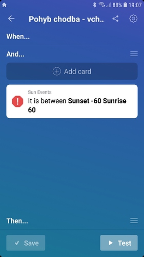

problem is in AND condition
Wnen PIR detect alarm (motion)
then switch LIGHT ON.,. thats all…
if i do TEST (when doesnt work) i got RED CROS in both SUN condition…

i test between as firts…, but same bad result

night (hour before and hour after)
i think that i test this settings (and no work), but i test today repeatly. Thx

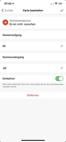

The App Sun Events app seems to refer to the same day with sunset and sunrise, so not at day change. So you have to think the other way around.
It is NOT between
Sunrise +60
and
Sunset -60
Please do not forget to activate the “Invert” button (see screenshot)!
This eliminates the time between sunrise and sunset.
I tried it myself this morning and it worked. But you’d better try it again tonight after sunset.
I hope it works now!
