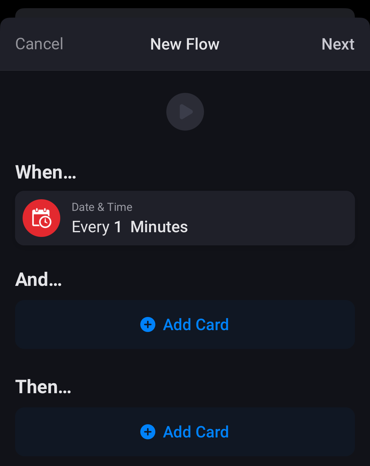

You can make a flow that runs every minute. If the condition applies, add +1 to a variable “counter”. The counter value tells you how many minutes the condition has been true.

How do I set up the flow to run every minute?
Is there any native support or do I need an app?
You start the flow normally with a when-card. Use the native Date & Time.
I do not know the nature of your sampled parameter i.e. how often it is typically changing. To save system load, don’t use 1 minute interval if it’s not needed. This was just an example.
My native Date & Time only contains three options, "Time is _ ", “Sun goes up in _” and “Sun goes down in _”
Is this a limitation that comes with the Homey Bridge Version?
Yes, but under AND you have more options.
Yes there are more options under AND…, but I still need the one minute trigger in the WHEN… part
