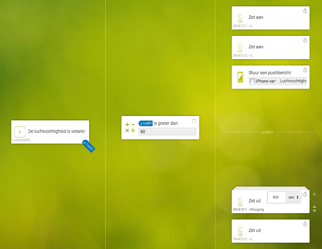

I have placed a Xiaomi Aqara Humidity sensor in the bathroom which works unbelievably well for its price. Its very small, feels high quality (for Chinese standards) and detects changes very quickly. In 1 minute after turning on the shower the commands are sent to the SAIX12 modules and the fan starts pulling the humidity out of the bathroom. I have set that when the humidity changes and it gets ABOVE 80% it triggers a flow that sends a command to SAIX12-#1 = #2 to ON + send a Push Message to my iPhone (temporarily, for testing purposes). When the humidity is going down and under 80% again it turns the SAIX12 modules OFF again with a delay of 15 minutes (because 80% is relatively high).

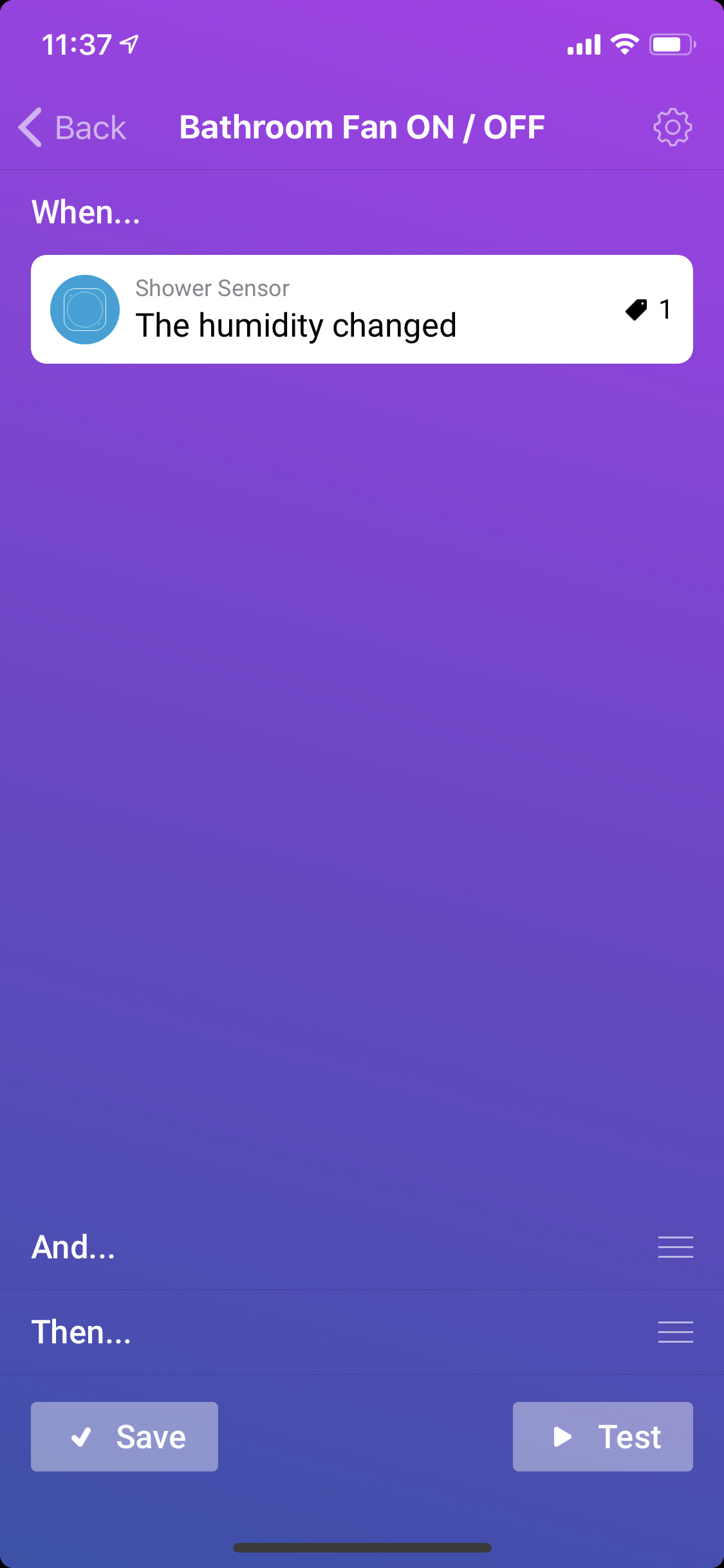

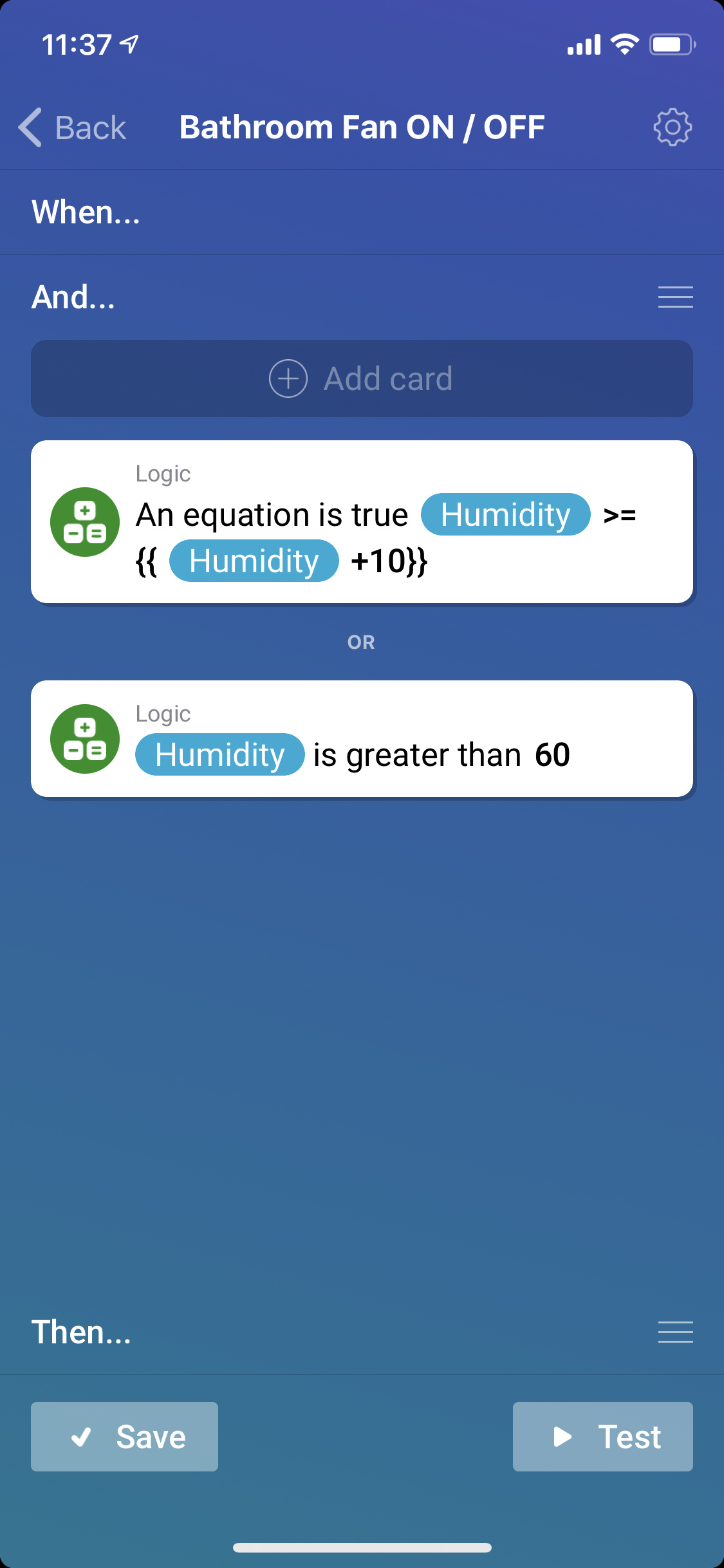

The problem i have here is that with every humidity change (which can be 0,1%) it triggers the flow everytime which causes the X10 signals to be sent over and over to the SAIX12 modules and it creates a Push Notification. These signals are unnecessary and i would like to create my flow that the signals are only sent ONCE after the humidity level reaches ABOVE 80%. Not that i am an “Aluhoedje” thats needs to lower the amount of signals but its just that i want to learn how to do this and to have the system use its resources properly.
I could not find the correct way to do this with the built in Homey logic. Preferably i would like to do it with the built in logic ways instead of installing other apps for this (i have seen Countdown, Better Logic used etc).
I have added a screenshot of the flow.
