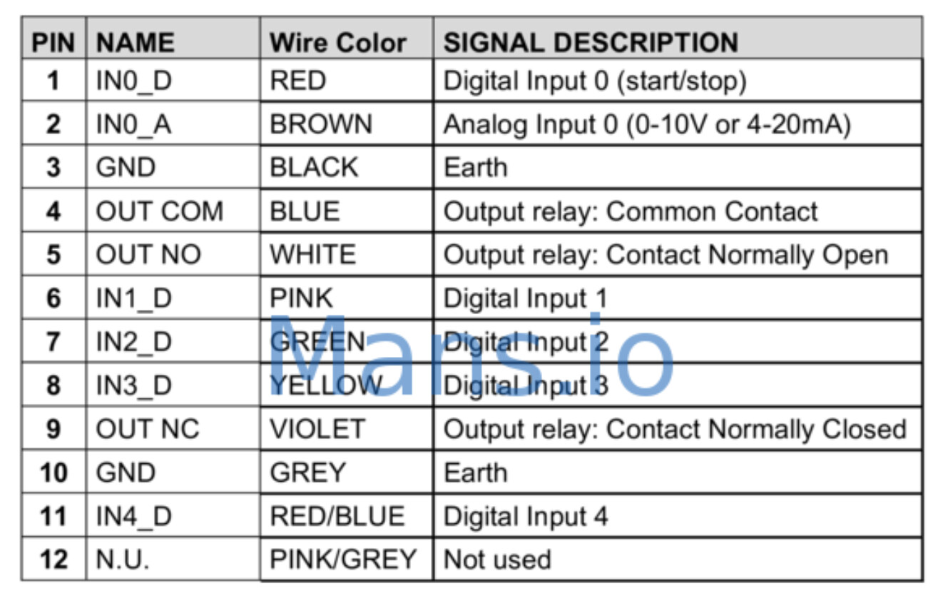

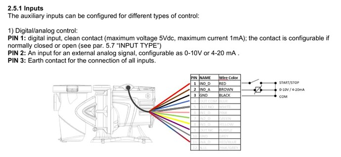

I would like to control a DAB variable speed pool-pump (ESwim 150) according to water temperature. I get the latter from my Ico, but how do I control the pump…? Let’s keep it simple:1) which interface do I physically connect to the pump, and how; and 2) how do I command it? Thanks!
Which interfaces has the pomp? What are the specification of the interfaces?
I don’t understand the scheme, but then… I’m a biologist ![]()
- I need to be able to start and stop the pump
- and then to control the speed (changing the input on pin2 from 0 to 10V apparently)
- What zWave (?) module allows me to do that? Where do I connect the second pole?
Thank you so much!
It looks like you can do it with the Fibaro smart implant and one or two power supplies of 5 and 10(12)V.

You can use a qubino 0-10V device on z-wave connect it to 3 (gnd) and 2 (IN0_A).
