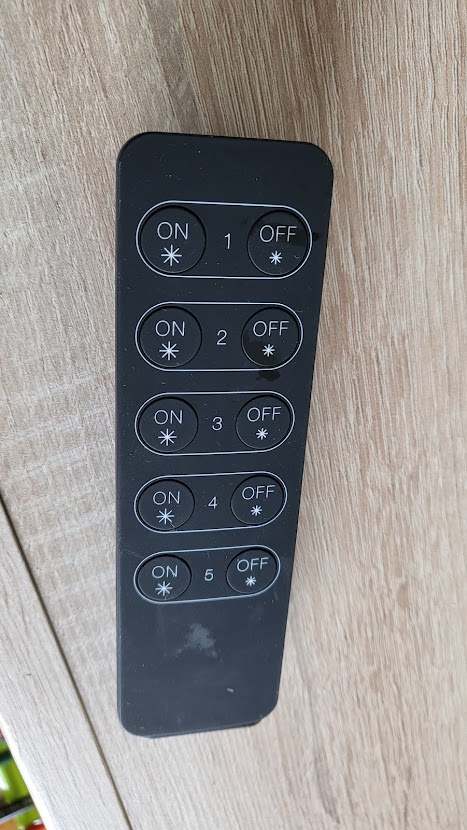

These light are located outside in my veranda. There are 6 lights in a row and the lights are controlled by the following remote:
This is not a infrared remote because i don’t have to point the remote to the lights. I can control them from almost the whole house.

I think it has no brand. It looks like this:
Maybe if you remove 1 light, or find the company who delivered / build it. Then the brand & type should be discoverable?
It should be this:
And those remotes are actually brandless, and used by a lot of different companies
You probably have to find an external device that can learn the codes of the remote :frowning:
