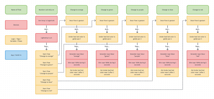

Thanks Rocodamelsheki and Fantross,
It worked and quite easily as well, once I chosen the correct led :sweat_smile:.
My only minor complaint is that once I used about 6 different colors, so 6 different flows linking each other. The 6th color seems to take quite long. It seems to me the more flows connected to each other the longer it takes before the “thinking” process is done and the light goes on.
Hm, this should not be a reason/problem. Maybe you post your flows that we can have a look on it.

But these are now only two color changes. But you wanted 6 color changes? Can you please share the remaining flows, you said that there are problems with the sixth color. So it would be good to see all flows.
Sure.
nr3
https://homey.app/f/1JOHQo
nr4.
https://homey.app/f/JJWHQo
nr5.
https://homey.app/f/rT_HQo
I only did 5 colors
Maybe there is some noticeable delay because all flows are executed one after the other. I have not checked it myself yet.
Maybe it is better to start the flows parallel. From the logic point of view simultaneous started flows should stress homey more, but I have myself flows in use which start 4 flows in parallel and have not noticed any problems.
