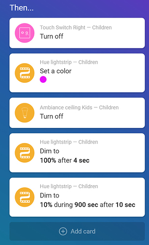

What’s your experience in the amount of actions you can do at the same time towards Hue devices (via a bridge).
I have a simple flow that does 4 Hue calls, one delayed after 4 seconds, and one after 10 seconds.
First of all, i have the feeling that ‘homey’ seconds are quite quick. But if you run this flow 20 times. You’ll notice about 10 to 20% of the times that one of the commands isn’t executed.
What’s the best approach. Is my Hue Bridge overloaded? Is Homey doing something weird?
I think i have 25 lights. That doesn’t yet sounds as too much.
I know i can use that card, but I don’t want to do that.
I want to turn off a single hue device, turn the color of the hue strip to X, make sure its at 100% brightness and for the coming 900 seconds dim it to 10%
