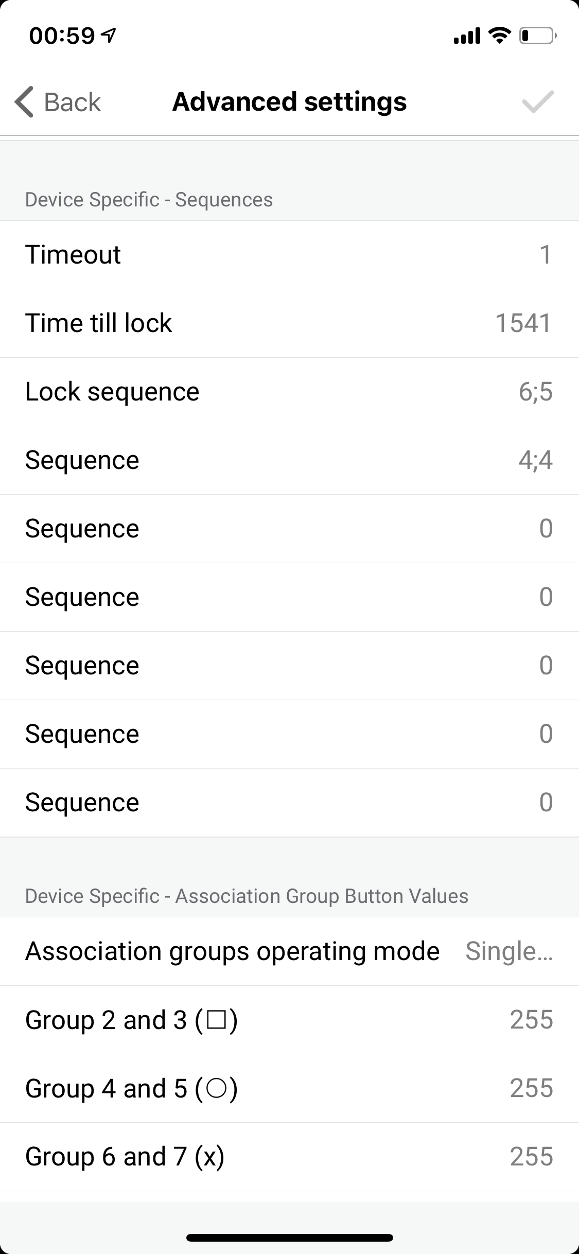

Yeah! I have done that but still no locking action here. Does this seem correct?
As in the description of the sequences, 2 of the same buttons can’t be after each other, so 4;4 is an Invalid sequence.
But also, do you wake up the keyfob just before you press save? (a value does need to change from the last save, otherwise the value(s) wil not be send)
The keyfob will not wakeup on its own by default.
Yes i have woken it up. Still no luck have also tried to reset it. Can’t figure out what I am doing wrong.
