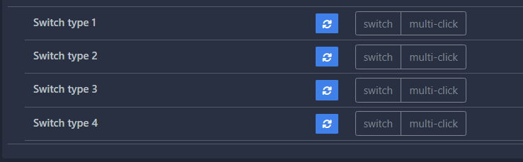

My device is already in Zigbee2MQTT: https://github.com/Koenkk/zigbee-herdsman-converters/blob/master/src/devices/custom_devices_diy.ts#L1289-L1311
This is what Zigbee2MQTT does when I change to multi-click and then back to switch:
//this is for multi-click
Write 0x00124b00279e70d3/4 genOnOffSwitchCfg({"switchType":2}
//this is for switch
Write 0x00124b00279e70d3/4 genOnOffSwitchCfg({"switchType":0}
And this is how the clusters look like in Zigbee2MQTT:
