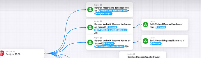

My power plug does not have a daily usage variable. So I calculate it myself:
At midnight i subtract the total power usage that I stored the night before from the current total power usage. After that I store the current total power usage again.
