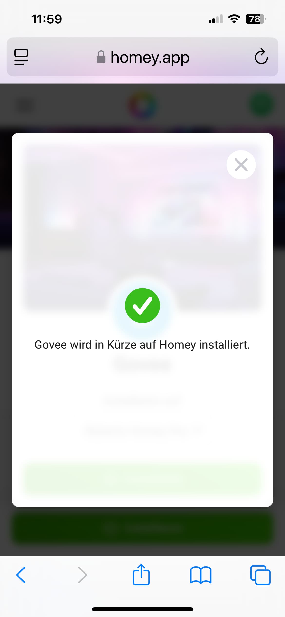

In homey pro i tried to install but it never installed. like shown on the picture.

I got this message after every install. And then the app is available under Apps, so it did install anyway. Just be shure to select the correct Homey to install the app on…
yes i know, i get the same message for ikea, sonos… and it will install immediately, but not with Aqara, govee, tuya…
