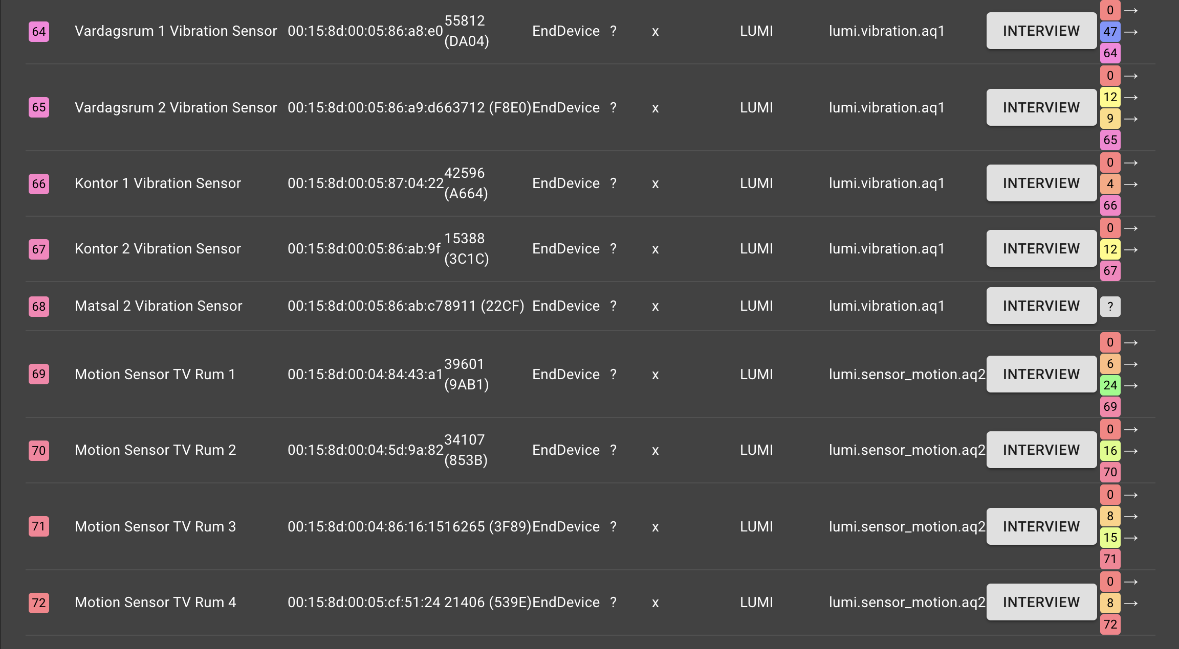

SInce the 5.0 update I’ve had major issues adding new zigbee devices. My house zigbee devices is mostly made up by IKEA Tradfri bulbs and controls, aqara motion sensors, aqara vibration sensors, aqara temperature sensors and some other devices.
Since the update I can still add the motion sensors for example, but I cant add any IKEA Tradfri Bulbs or temperature sensors which is a major issue for me as I have like 10 new bulbs that needs to be connected.
I’ve tried to restart all the apps, I’ve downgraded and upgraded Homey, I have the latest update of Homey.
Dont really know what to do and how to solve this issue.
All the Zigbee devices that was previously added work well. I have 72 zigbee devies atm.

So for the other options to try first: Adding a device list is really helpful, so thanks. It seems like you added enough routers before adding sensors, so that in itself is ok. But still it looks like a lot of devices connect straight to Homey, which is limited to around 15. The rest must go through routers.
Aqara sensors are really reluctant to change their initial route though, so I think your problem is that direct connections are full. You do own a lot of Zigbee, so you may be running into limits as routers are also limited in how many they will route for, and also the amount of router “hops” is limited. A hue bridge will max out at 50 devices before you need an extra bridge, and you are over that.
