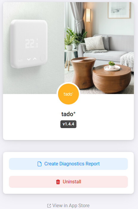

Sorry, I meant the Homey tado app.
I am using the one that was found when adding a device to Homey:
There are several version kicking around because tado kept changing the API.
But as you can see it finds all my devices:
I think i have the same app is the official one

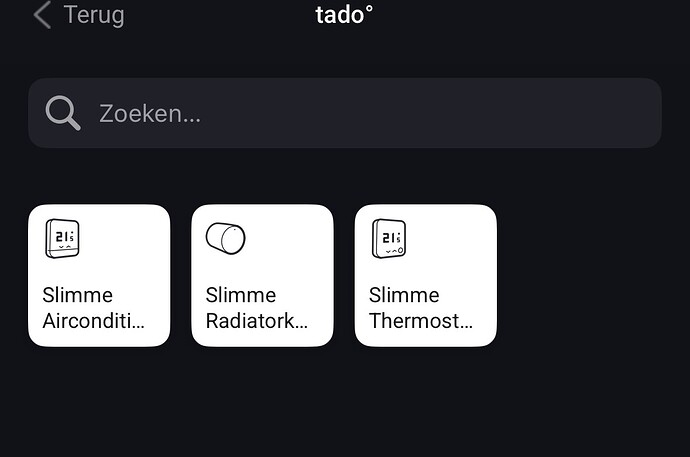

When adding device I click tado app as suggestion and get this
When clicking here something I have to connect to login and then it says no devices found. I do work with tado x not the older v3 is it possible tado x is not available?
Hmm, now that I’m not sure about as all of mine are the old type, so maybe that is the issue.
I’m fairly new to homey and automations but I suppose you need the apps to connect or can you connect devices straight to homey? For the moment I’m only on the free cloud version. So I don’t have the home bridge or anything. Not sure it would be possible with this bridge?
I’m not sure if the tado X requires Matter or if it should work via the cloud as well.
If it requires Matter, then you will need a Homey Pro or Homey Mini as the Homey Bridge doesn’t support it.
I have asked if the official tado app supports tado-X devices and will let you know if I get an answer.
I presume you have a tado bridge that connects your tado-x devices to their system?
The official answer is tado x devices are not supported via Homey cloud, so you will need a Homey Pro or Mini.
