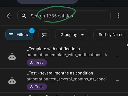

My setup
I have these HA devices ‘installed’ @ Homey Pro 2019 (1GB RAM):
MQTT (incl Z2M) has this number of entities:
HA CPU & RAM (of course it runs way more than only MQTT):
Homey: The needed apps use this amounts of RAM :
(In general they use double on a Pro 23)
