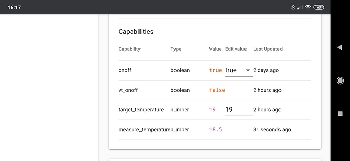

If I check the developer settings, I see that the setpoint is higher than the measured temperature, but the capability is still ‘false’. When will it switch to True?
When the diff is larger than the hysteresis it will trigger…
And here I guess you have hysteresis = 0.5.
