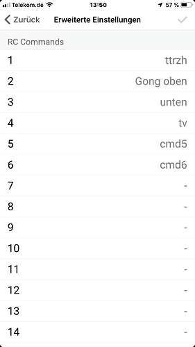

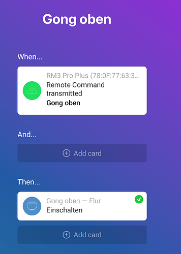

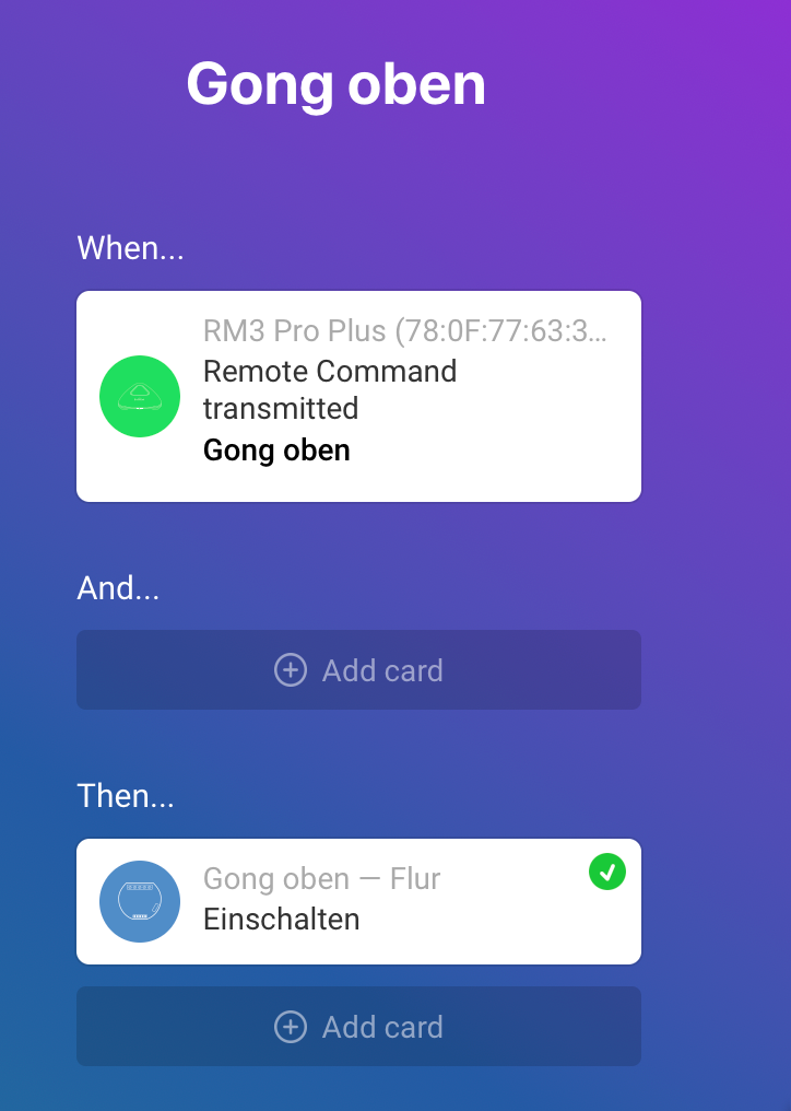

i think i did everything right he learns the ir komandos i can select it on the flow map it doesn’t work then someone has an idea what is wrong

That depends on what u wanna do with this flow. If u wanna send the signal then u need to use the first card in the THEN colom. If u wanna use this flow as it is then u need another flow that sends the signal by putting this first card in the THEN colom.
I do not understand
I would like to use a fused ir signal in a flow which then switches a shelly so if the remote pro receives the signal then switch the shelly
As far as i know the devices are made for sending IR/RF signals, not receiving them. So u can make a flow like WHEN virtual button is pushed THEN send a (IR/RF) signal to the television to turn it on.
It is not possible to take a remote, send a signal to the Broadlink device and start a flow from there.
ok i understand
is there a way to do this with another device?
U could use something like a button or a switch. Aqara wireless switch?
Then how would u wanna send an IR signal then?
Maybe make a virtual device in Homey and turn that on in any kind of way? Add it to Google Home and use speech to turn the virtual device on? Just guessing here.

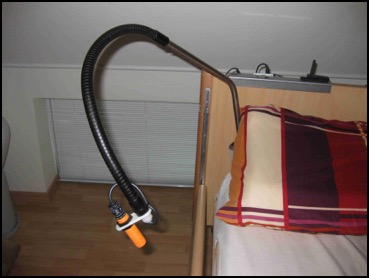

thats the device and 1 sensor i can touch it with my head
i dont can speak
