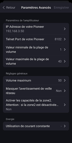

I am trying to set up my Pioneer VSX-S520D receiver on my Homey Pro (2023)
I have scrolled the entire thread without being able to solve my problem…
My receiver is installed but is always on error with « device unavailable » message (or whatever the message is in English !
I have checked the IP, and the telnet port is 8102…
Is there anything I am missing ?

I have checked the GitHub page, without success… I have posted an issue.
Hope that can end up to a more stable app !
